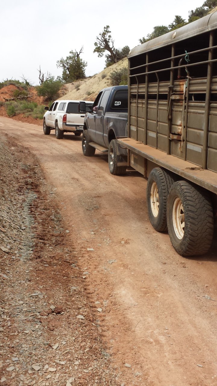

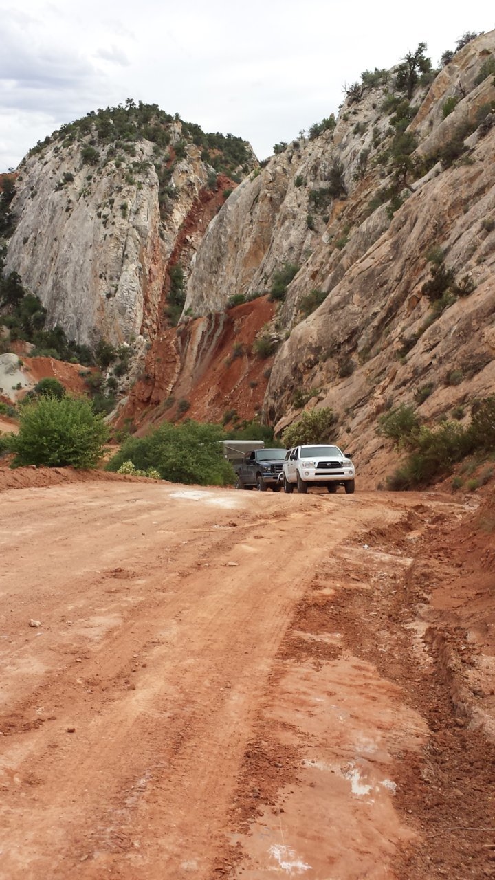

    Having trouble getting out of 4lo is a common problem with all 4X4 vehicles including the old school trucks with manual shift levers. I've been driving 4X4's since the 1970's and have had several instances where I had problems. So far putting it in reverse and backing up 10-15' then pulling forward 10-15' has always worked. Although I've had to do that little dance several times on a couple of occasions.
    In 2016 I was in the Utah desert when I came upon some cowboys rounding up cattle on BLM land. Their F250 was 4X4, but for whatever reason wouldn't shift into 4X4. They were pulling a stock trailer with horses and cattle and couldn't get enough traction in the dirt road to get up a hill in 4X2. I pulled them up with my Tacoma in 4lo. Total weight of their truck and trailer had to be 15,000 lbs. The little Tacoma was pulling it's guts out but got them up to the top. I only drove 100 yards in 4X4, but it took me several tries to get her to let go of low range.
