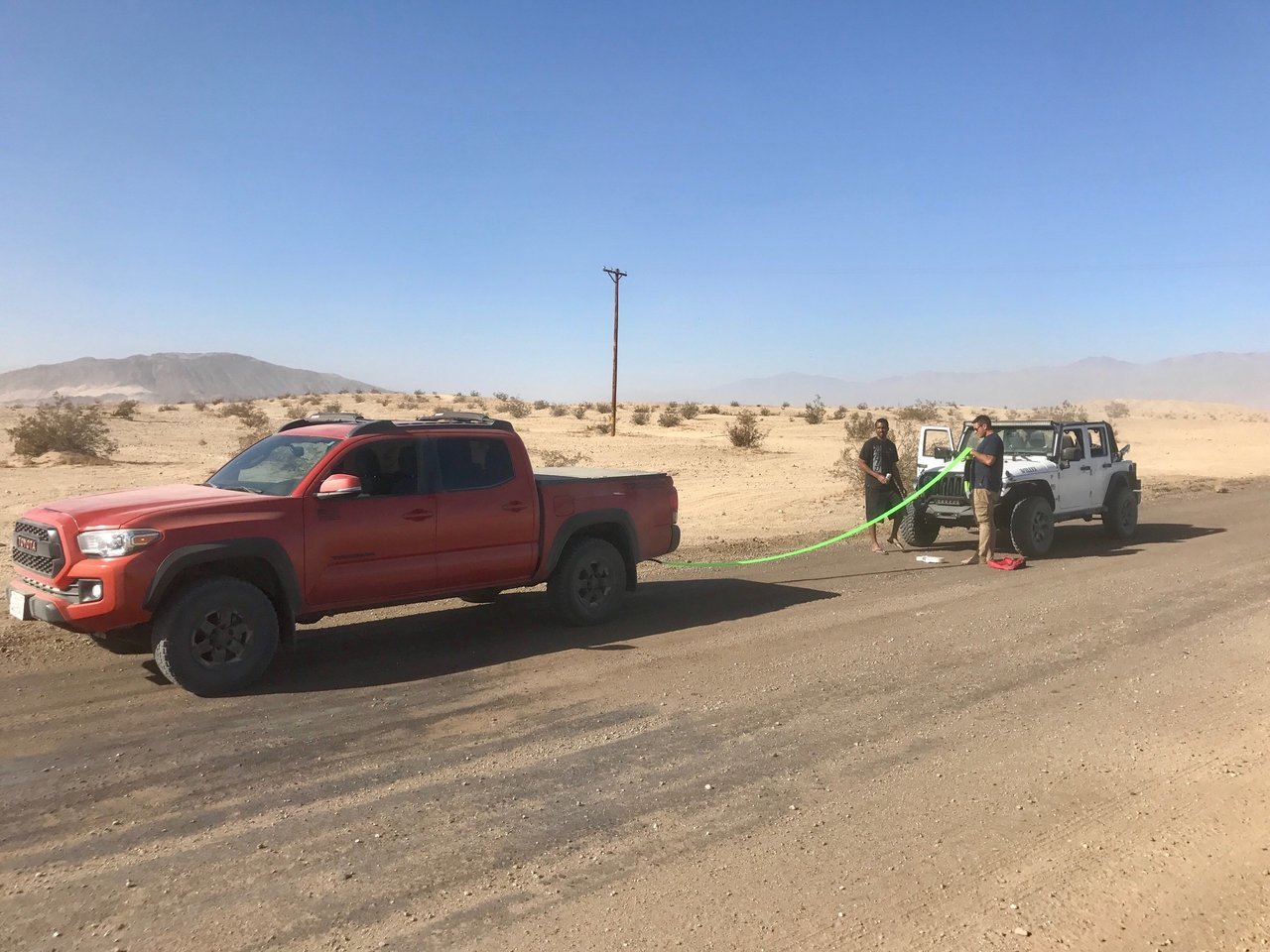

    MY hatred for Jeep.... I posted a thread about it in the third gen section because my 3rd gen Tacoma had to tow that POS all the way back to civilization. Then we waited like 5 hours for a tow truck, then paid $200 (on top of jeep roadside assistance because we were too far out and Jeep was too cheap to cover the difference), THEN it sat a dealership for 26 days while they tried to figure out what was even wrong with it. First they said bad PCM, replaced it same problem, then they sat on their ass for two weeks until a corporate Jeep engineer came out and turns out it was a bad PCM after all (I guess two bad ones in a row). Finally got the jeep back 3 days before it could be filed for lemon law -_-
    I'll certainly never take it offroading alone, I'll only go if a Toyota is there for backup now lol.
    It left me enraged because I've NEVER been actually stranded, maybe I'm just lucky but I think its because I've always offroaded in Tacomas, 4Runners and Landcruisers. 15 years of offroading, 5 different rigs most of them with over 100k+ miles, and I've NEVER been stranded before this. I've been stuck and taken hours to get out, I've fucked shit up and had to limp home... but I've never been straight just stranded in the middle of no where until this BRAND NEW 2017 Jeep wrangler with only 6k miles on it decided to take a shit on me 200 miles from home and 10 miles from the nearest road. :mad:
    We weren't even doing anything stupid we were just camping and exploring when it just... died.
    I'm more pissed off than I should be and wish I could say I'll get over it but I'm obviously taking it more personally than I should lol
