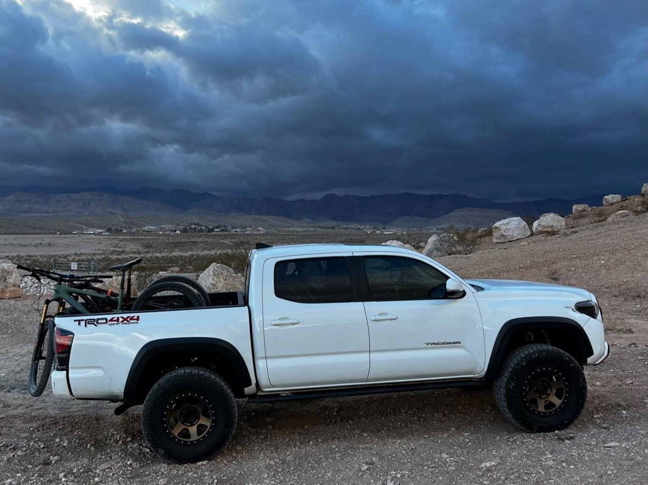

    2017 Tacoma TRD offroad. On Saturday after doing a short run up a hill in 4L I wasn't able to disengage 4low so I drove it slowly to the closest shop which was in Cave Creek. I just heard back from them today they aren't able to get anything from the diagnostic codes to pinpoint what is wrong and I have to take it to a Toyota Dealership. Few questions; first can anybody recommend one dealership over another for a repair like this? Alternatively, is there a trusted shop outside of a dealership that is capable of tackling this and can maybe save me a few $$ as I know dealerships can be silly expensive? Hell, I'm already racking up quite the rental car bill. Has anybody had this issue and any insight on repair/cost?
    Truck has 115k miles so it's out of any warranty. I bought the vehicle new at Berge Toyota in Mesa and live near downtown Phoenix.
    Here's a picture when it was happy and working :-/
