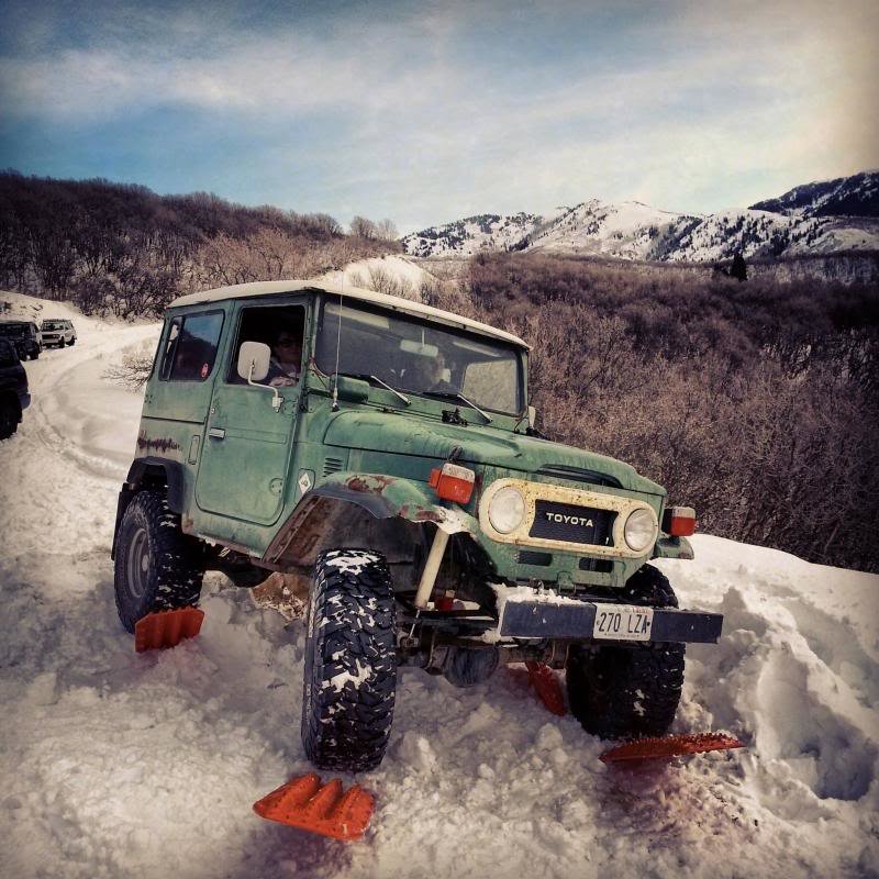

    A winch is a great tool for snow recovery. After that these are my favorite to things to aid in getting out of snow.
    Maxtrax
    1512210_10203003524959527_1366047559_o_z_a52b527e15e6d330216f2cc1bf682daca655abc8.jpg

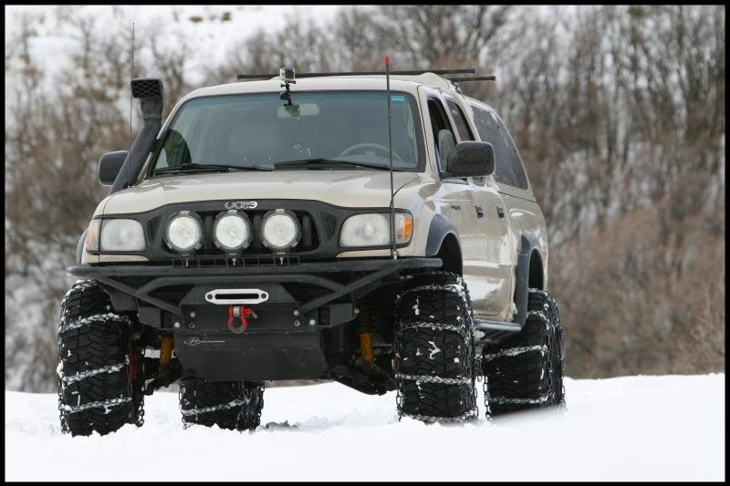

    Chains
    Not everyone has the money to buy a winch, or chains or maxtrax. But everyone can take a shovel. A shovel can almost always get you out even it it takes a while.

    ^The maxtraxs have been a huge help for me. Mine are starting to show a lot of wear and tear though. Nubs broke, the bottom spikes for gripping are smashed, and some areas have just wore from tire spin (I try to limit it, but it happens.)

    Wheelspin is what will destroy the traction boards. As you say, sometimes it's hard to not have a little wheelspin but avoid it if at all possible. Wheelspin is not needed for the traction boards to work.

    Generally its when I take them out for other vehicles. I forget to tell them not to spin the tires and never fails that they try and gun it.
