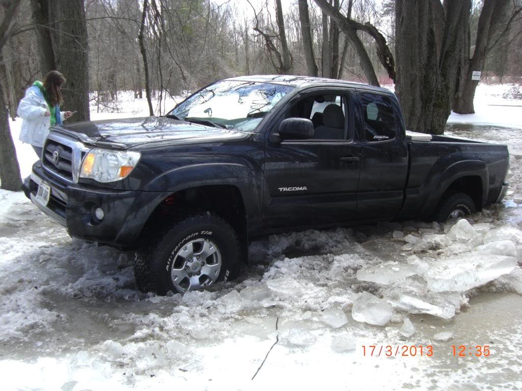

    This just happened to me as well. Can't get out of 4lo. (I had it in 4lo to teach my daughter to drive manual).
    Upon inspection I noticed there is a vacuum line broken off at the transfer case actuator. I think I broke it off doing this:
    My ADD actuator has crapped out twice and been replaced under warranty. I don't think the actuator with the broken vacuum nipple will covered under warranty :-(
    Did you fix yours yet?
