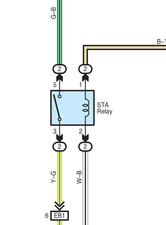

    If you have a test light or voltage meter check the powers and grounds at the STA Relay.
    Pins #1 and 5 should have power with key in CRANKING position.
    This should help narrow down the problem, quicker and easier.

    Not between them.
    Each pin should have 12v.
    One end of the meter (black) to a known good ground. (Battery negative)
    The other (red) to the relay pin.
    Or is this what you did?

    H
    Black to good ground, red to 1 has 12v
    Black to good ground, red to 5 nothing.

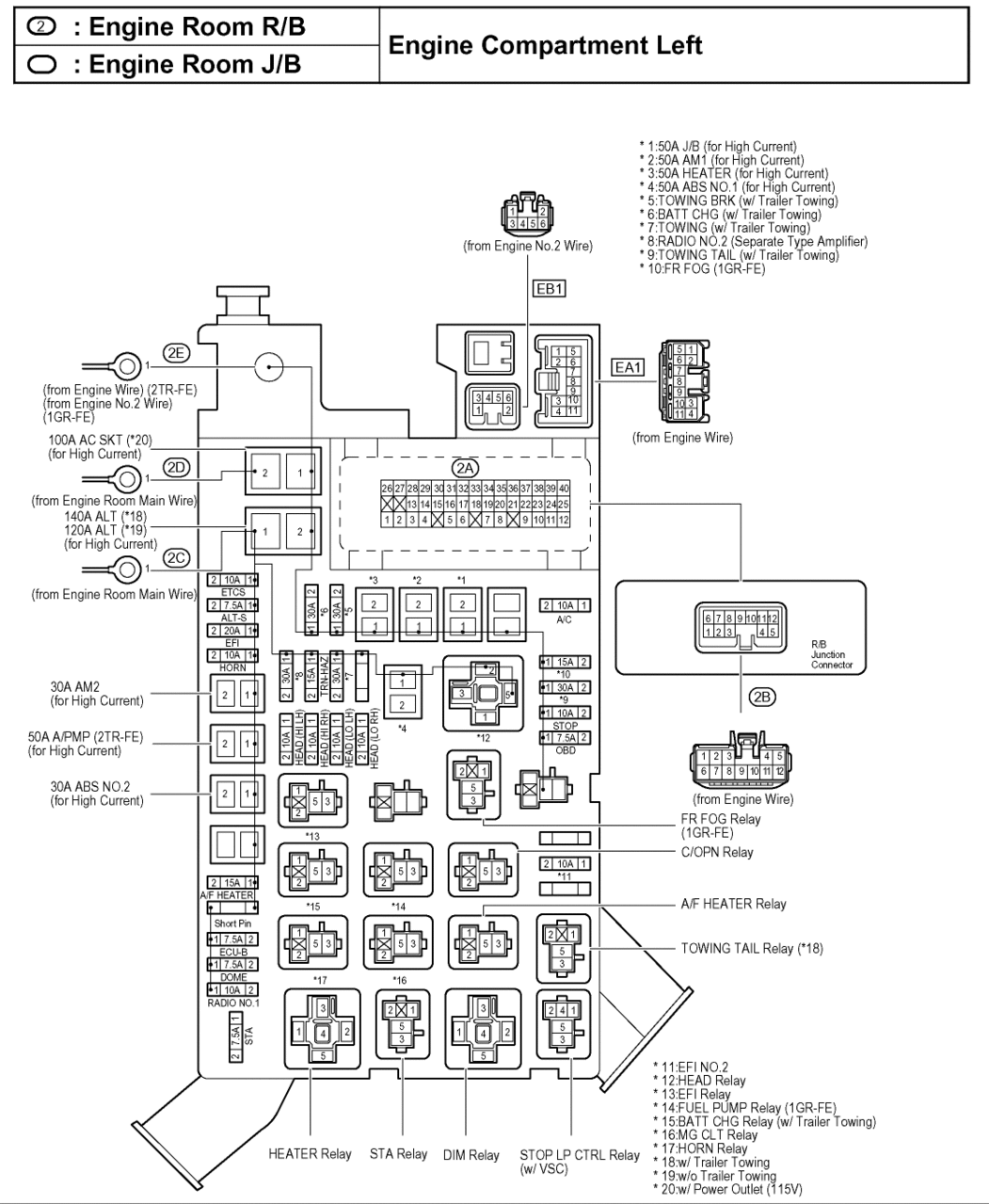

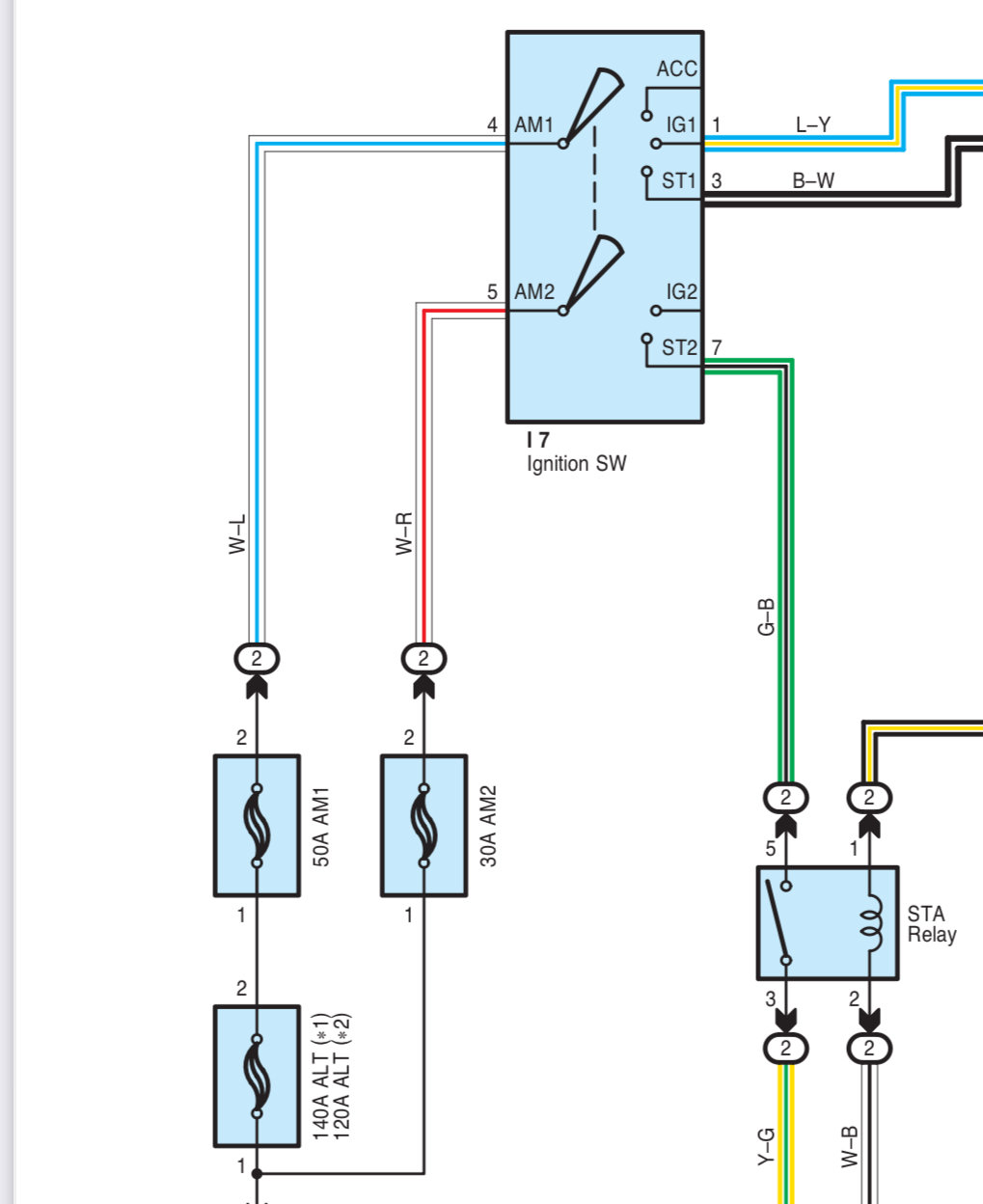

    Pin #5 is powered through the ignition switch.
    Check the 30A AM2 fuse. If it’s got power. You are going to need to get to the ignition switch.

    The 30A AM2 fuse also feeds the gauge fuse.
    Let’s hope you get lucky with the 30A AM2 fuse. :fingerscrossed:
