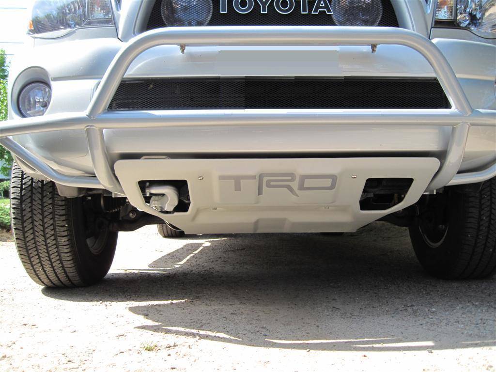

    Toyota Recovery Hook Part #51961-35080 ($75 +)
    2nd gen recovery loop. (Made by Member mustangwilly)
    Can't confirm it'll work with TRD Skid Plate

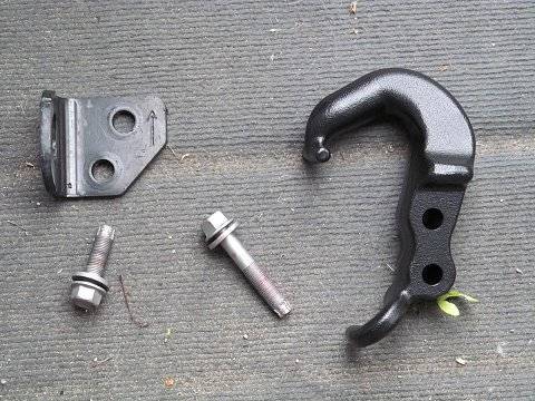

    He also needs two bolts P/N: 90119-A0193
    Stock parts on the left, bolt and hook on the right.

    Good Call, My Bad
    Mentioned the longer bolts, and failed to post Part #
