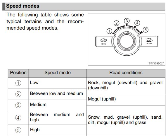

    the hammer instructions if you google it does not tell you to you have hammer screws. read the manual.
    toyota manual tells u you can use crawl in mud. you probably does not have a TRD OR and just trolling :D. so just google the manual if you dont got one,.

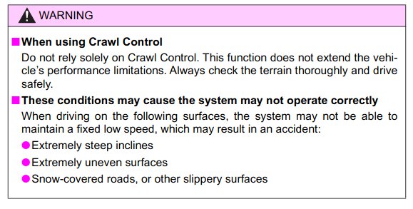

    crawl.jpg '
    It does specify mud in the table, but you've also ticked two of the boxes under the "These conditions may cause the system may not operate correctly" box - steep and slippery. To me, and probably anyone else that has driven in mud, that would say that crawl control is the wrong tool for the job, but might be worth a try just for giggles. Not worth a "CRAWL CONTROL FAIL" headline though.
