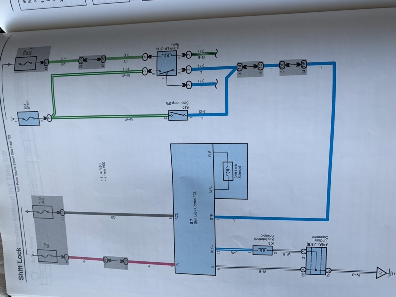

    When the ABS senses pressure but no Electrical power from the brake light Switch, it turns on the warning lights on the dash. Somehow brake switch power is not getting everywhere it needs to go.

    So what does this mean? Lol messed me all up with that diagram

    I would pull the center console and verify I'm getting voltage at the shift Lock solenoid. It could be defective.

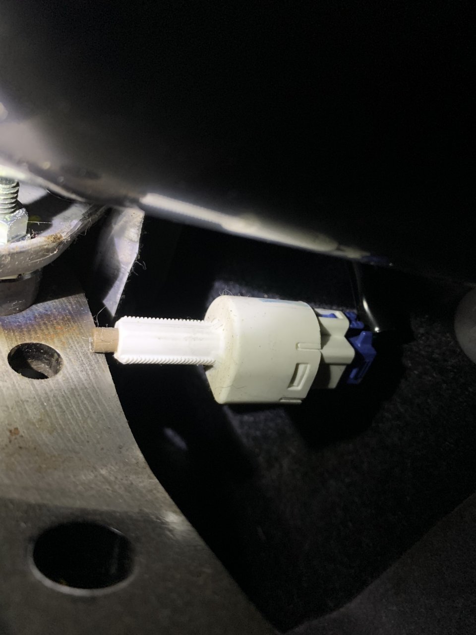

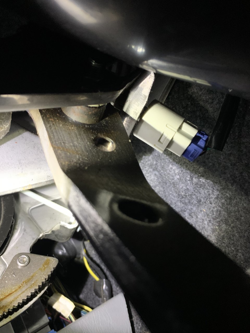

    It’s behind the break pedal, to take it out you twist it and it’ll pop out. to put It back in push in and twist. You can also adjust it that might be what yours needs it’s when you push your break down it releases the pin. You’ll see what I’m talking about. It’s Called a brake light switch. Around 20 Bucks at advanced auto. I had to replace mine. Same thing happened to me, wouldn’t go out of park. 3B6407B1-B2E6-4208-AF85-F3BD19762BDF.jpg

    But he said the brake lights work.
  11. Aug 28, 2020 at 6:26 PM
    #31
    KILLINTIME
    KILLINTIME Like a Villain
    Dec 11, 2015
    #172005
    2,686
    Oh, well Scratch my idea then. I skimmed the Original Post and apparently missed that part.
