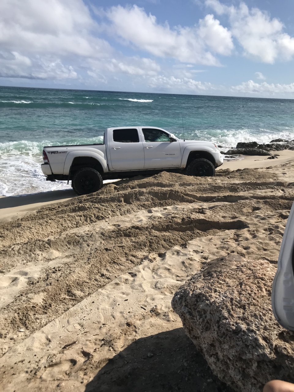

    I got stuck in deep sugar like sand driving in my 2014 Tacoma TRD Sport.
    I was in L4 and all the power was going to the front left and right rear tire.
    the right rear was off the ground since the left front was dug in so deep!
    The only tire not stuck was the left rear on kind of hard sand due to reef under the sand.
    The left rear tire had no power to spin.
    Couldn't even move at all. Finally dug myself out. I didn't know that if I put it in H4 I could have gotten out!
    Arrrgghh!!! Tuff lesson!

    How long did it take to dig yourself out?

    Did you air down the tires?

    4high has les torque, so no that would not have helped. Always airdown in deep sand

    ATRAC and/or your rear locker? Or do the sports not have either of those?

    Sports don’t have ATRAC. Air down and keep momentum. Follow that and you’ll be fine.

    Your truck in 4L has no locker (no locker on the Sport) and axels are open. In 4H you have automatic limited slip front and back. It’s an electronic limited slip. You would have had more traction in 4H with the automatic limited slip than in 4L.

    Buy some traction boards or simply carry two pieces of heavy plywood a cut like 1' x 3' to stick under the wheels. Also alot of beaches require these plus a 1'x1' jack base board. And of course carry a shovel.

    Dangerously close to the shoreline, you’ll definitely sink there. Unless you were digging and sliding?
    Airing down helps out tremendously providing you have a compressor to at least air up enough to drive on the road after. It’s all in the fun of the learning experience!
