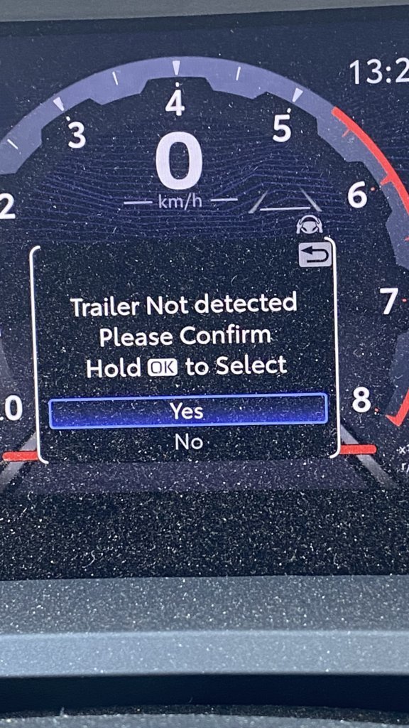

    Want-a-taco
    Want-a-taco Well-Known Member
    Apr 20, 2024
    #448309
    396
    New Brunswick, Canada
    2024 TRD Offroad 6MT black
    Trailerless, you need to say yes, the question is different than when hookingupload_2024-10-11_21-44-30.jpg
