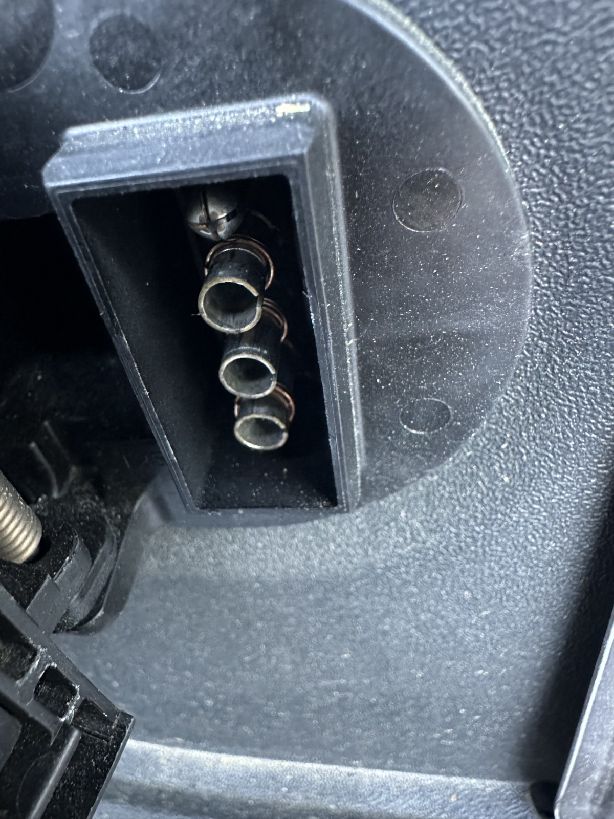

    Yes sir. No dice. Tried selecting and deselecting again. As well as deleting the trailer.
    as I look at the 4 flat on the truck I see little metal rings around each prong. Does everyone have this? Just trying to figure this out.

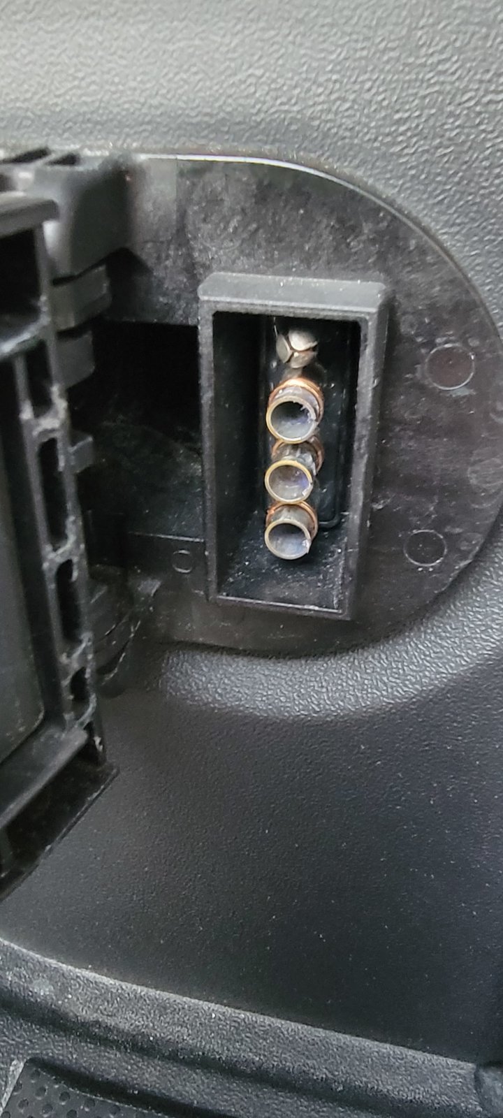

    Here is mine and I noticed when I reselect and deselect a trailer it displays an "error" in the center display for a second and then goes back to the some safety systems are unavailable while in trailer assist mode.
