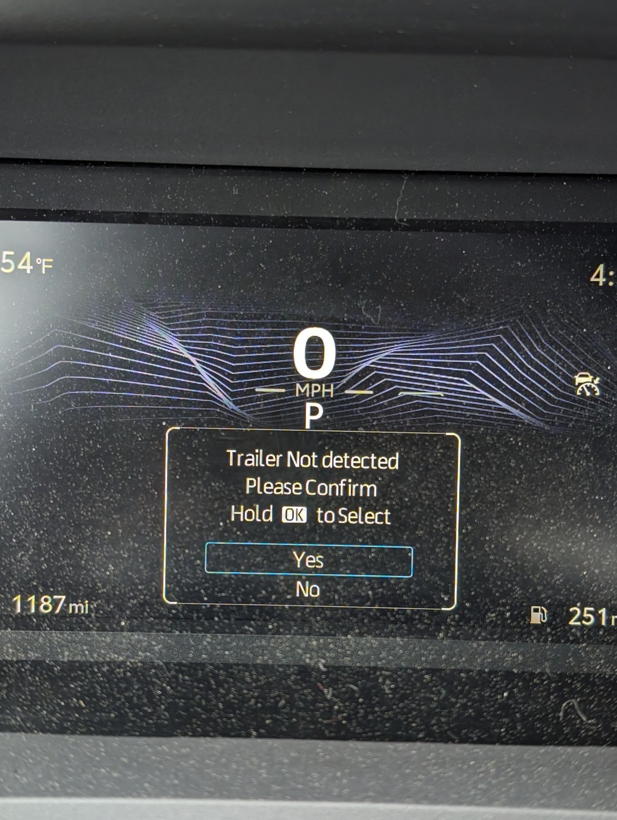

    Fixed it,,, Hook up to a trailer with a 7pin connection. Set up to tow new trailer, drive through a couple right and left turns. Park it, disconnect it. When cluster asks if trailer is Disengaged yes or no... Enter YES and magically everything is tacoriffic again.

    Did you answer the disengaged question yes or no? That's what made mine mess-up the 1st time.

    There is actually a question that comes after you tell trailer mode that you don't have a trailer hooked up. This pic comes up after.

    I believe I answered no and probably should say yes instead

    Try hooking up to 7pin again and set up as a different named trailer drive it right and left and park it, disconnect it and then tell truck you are disengaged. Maybe it will reset correctly then.

    It seems that you do have to drive it before the computer recognizes the trailer has either been connected or disconnected.
    I tried just plugging in and unplugging the trailer lights several times but never got the message on the dash. It wasnt until i drove it around the block after connecting/disconnecting that i got the message.
    Dont know if it matters, but I didnt kill the truck before driving around the block after disconnecting the trailer.
