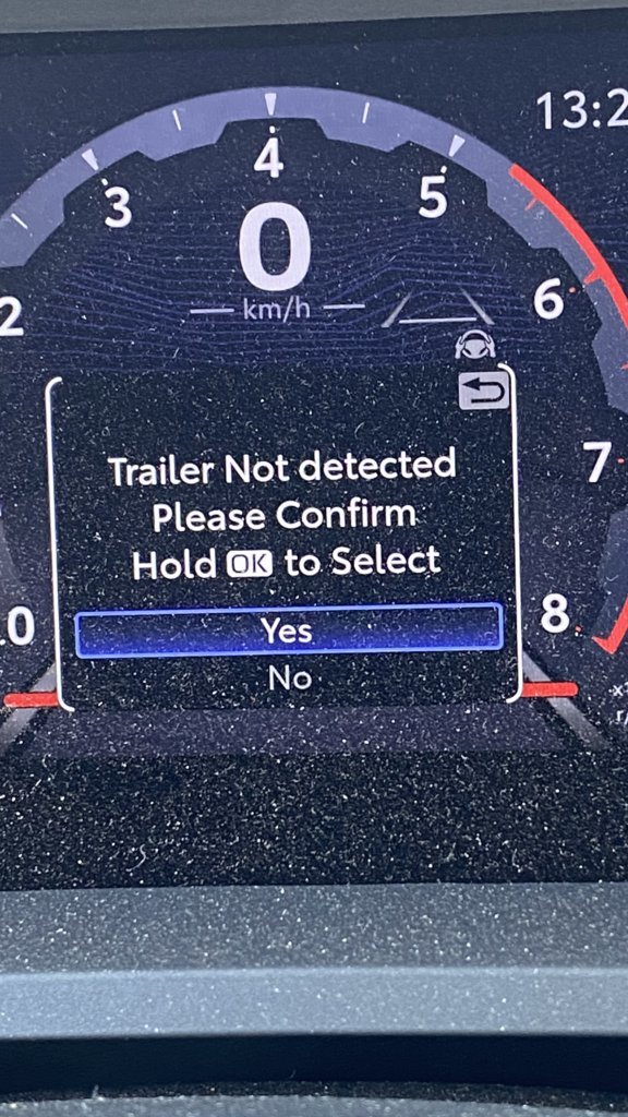

    I got “trailer not detected” when I drove off without the trailer. So I had to answer yes. The message is almost identical, only difference is the “not”, which changes the answer. The answer is yes when connecting and yes disconnected.
  20. Sep 30, 2024 at 12:30 PM
    #180
    Want-a-taco
    Want-a-taco Well-Known Member
    Apr 20, 2024
    #448309
    396
    New Brunswick, Canada
    2024 TRD Offroad 6MT black
    This is what I meant after driving trailerless.
