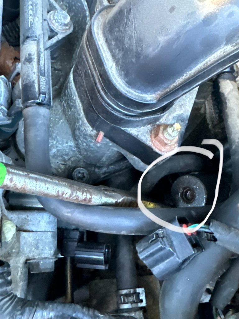

    You guys run into this? Was able to remove the bank 1 valve but the bank 2 valve is not budging (see pics) and before I break something I will regret I was wondering if anyone had any tips for me…
    thanks

    Can you rotate it?
    Use a penetrating lubricant and allow it to soak then try rotating it and pulling at the same time. Not hard or too forceful, Slow and steady wins the race.

    That looks like the OCV filter?
    If so it's an allen socket.
    This is where those long ball head allen sockets come in handy.
    A little tappy, tap, tap... helps sometimes.

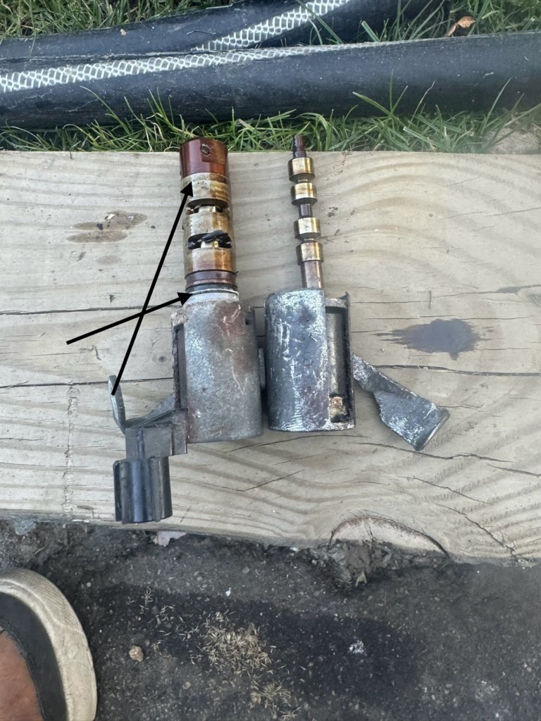

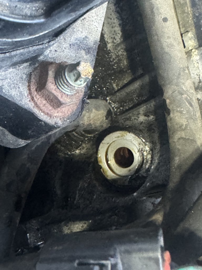

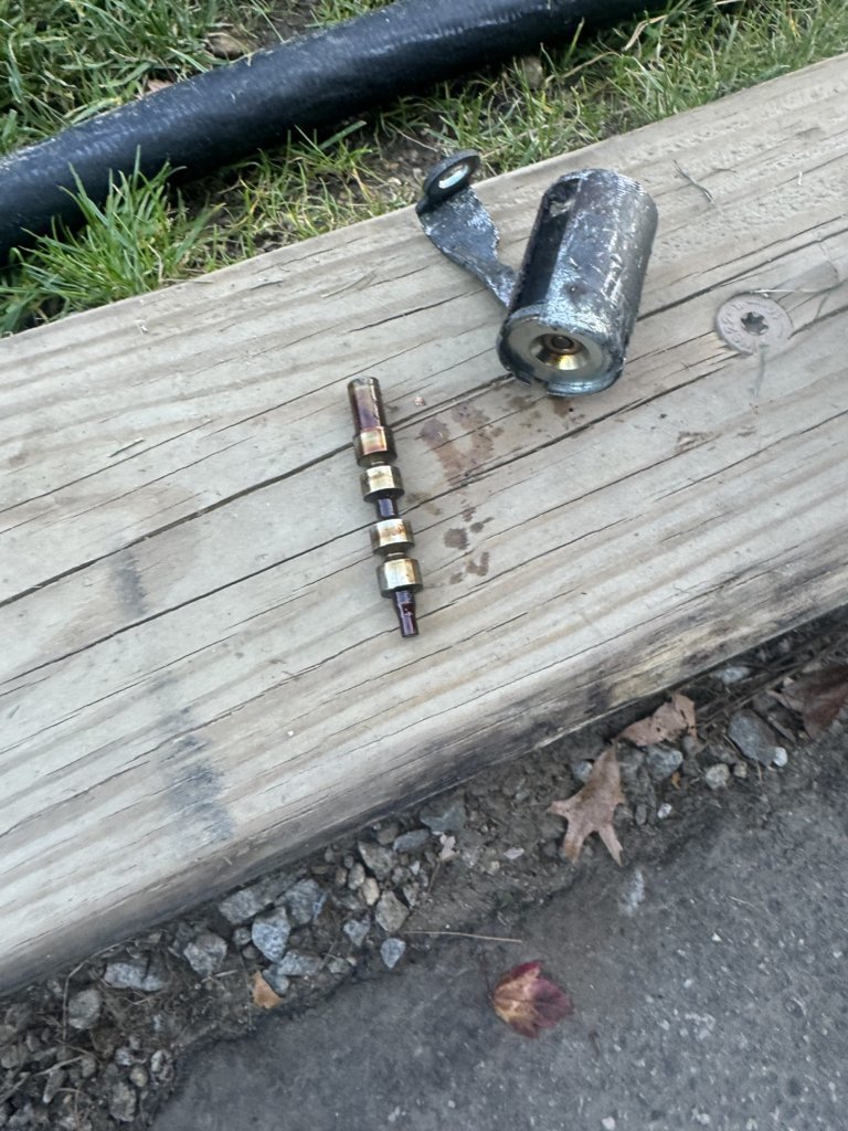

    I did That snd then this happened. The core came out but it’s still stuck in the block
    See the pics :/

    Ok. I see what we are working with now.....
    I'd want to see if I could pull it out.
    Not sure I'd want to try and easy out. That may allow metal debris into the engine.
    Dang man. That sucks.

    welcome to my world. Looking at the other it looks like maybe I can pry something into it and shake the rest out. In reality there shouldn’t be much holding that in right!?

    That is a tough one.
    Maybe a small blind bearing puller and a slide hammer.

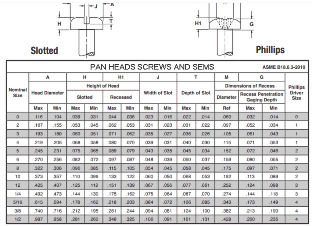

    I'd try the pan head screw trick first.
    I'd maybe even try to make a "puller" out of it if I could.
    It's do able. But it will take some "backyard" engineering.

    That #8 screw is way too thin. I’ll let you guys know how it goes and thanks for the tips. Def some backyard engineering happening here.

    Let me dig around the garage here and measure the head diameter of a few screws and bolts.
    Do you have a rough guess of how big the bore is?
    My brother had the blind hole puller kit. I might be able to give him a call and see how small it goes down too.
    I know it's a mater kit. He had to buy it back when we were racing and building quads.

    See the head diameter below.

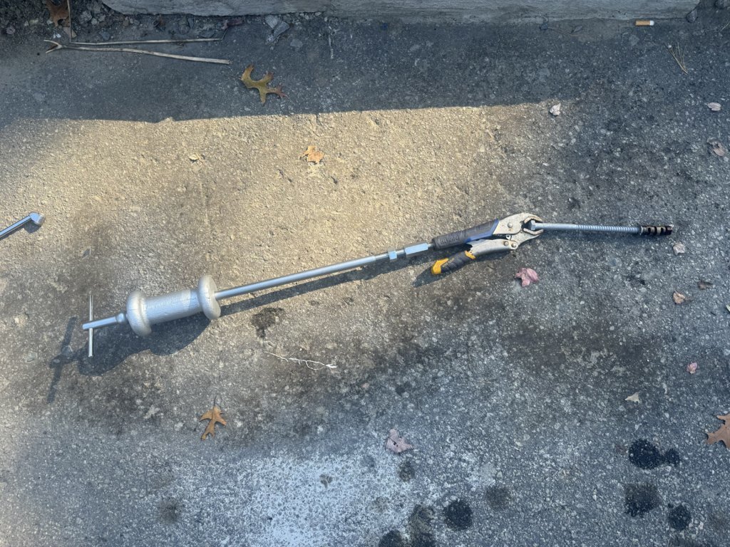

    Got it out! Sad how easy this hammer slide made it. 1/2 inch lag screw 8” with a craftsman hammer slide I grabbed from Lowe’s. Undo the bolt from the vice grip and use one of the attachments that come with the slide to attach them together. Just get the air box out of the way.
    Thanks all for your ideas and help!

    Nice.
    That looks like something I'd rig up.
    If you don't have at least one tool in your garage that looks like it has "bad news" write on it.
    You ain't never worked on much. :D

    Slide hammers can be a godsend at times like these.
    Good job - Slide Hammer, Vice Grips and a long Lagging Bolt.
