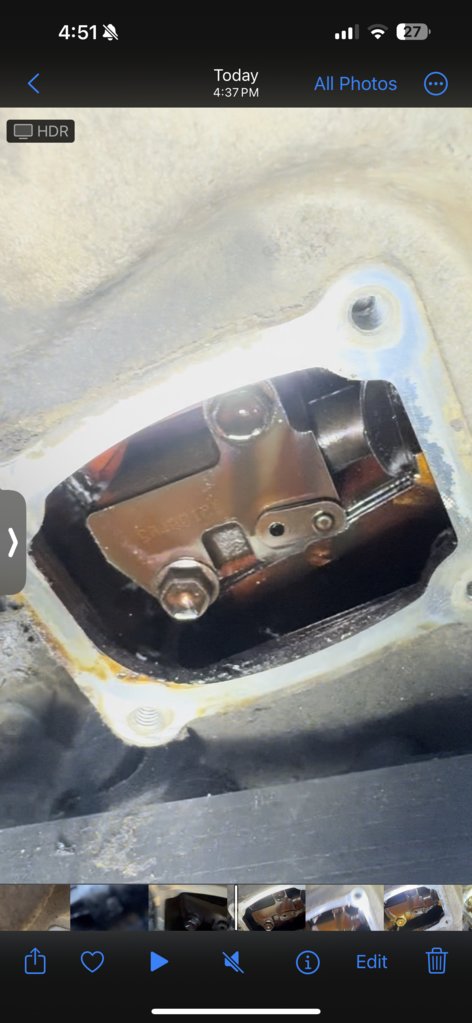

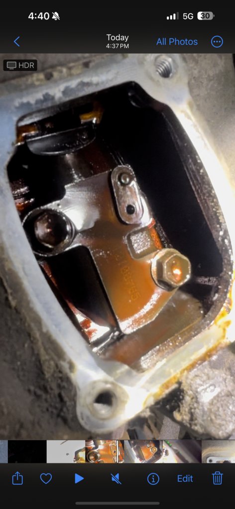

  4. Oct 22, 2024 at 1:53 PM
    #24
    MarkNap128
    MarkNap128 [OP] Well-Known Member
    Dec 15, 2019
    #313436
    211
    Mark
    West Warwick RI
    2013 Black Tacoma TRD Sport 4x4 dbl cab
    None
    This pics better
  5. Oct 22, 2024 at 2:11 PM
    #25
    SR-71A
    SR-71A Define "Well-Known Member"
    Jun 1, 2018
    #255145
    7,876
    Zack
    Southern Maine
    2012 DCSB, TX Baja Edition. Barcelona Red
    255/85/R16 Falken Wildpeak MTs, Mobtown sliders, ARB bar, SOS front skid, Icon RXT leafs, extended & adjustable Kings, JBA UCAs, OVS wedge RTT, dual AGM batteries, Gen2 xrc9.5 winch, CB, GMRS, S1 ditch lights...
    That is... some redneck shit right there haha. Glad you got it out!
    How many miles on truck?
  6. Oct 22, 2024 at 3:47 PM
    #26
    TnShooter
    TnShooter The TacomaWorld Stray
    Sep 2, 2010
    #42625
    21,061
    Deogee
    07' TRD Off-Road, Auto
    STOCK
    That does not look bad at all.
    Looks pretty good to me.
    Have you checked the VVT Screen?
    There is a screen that can get clogged and cause timing codes.
    BTW, this is "bad" AKA: Stretched
    Torspd and Jimmyh like this.

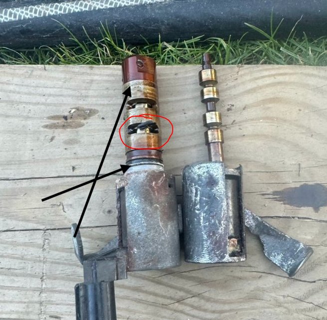

    what’s sad is how easy it was to get it out once that ghetto hookup was in play lol
    SR-71A[QUOTED] likes this.
  11. Oct 23, 2024 at 4:54 AM
    #31
    SR-71A
    Jun 1, 2018
    #255145
    7,876
    Zack
    Southern Maine
    So why were you changing both OCVs in the first place? This is one of your pics from the first page. What is that? Doesnt look right
    Has the truck had regular oil changes? As TnShooter mentioned you can check one of the oil screens to see how it looks. Believe passenger side is easiest to get to behind the PS pump with a socket & some extensions. But tbh, if the truck has had regular oil changes that probably isnt your issue.
    Id start with the P0020 code and electrical first. P0020 indicates an open or short on bank 2 sensor circuit. Possibly you damaged the sensor harness when you were replacing the OCV? You also mentioned issues with the "vvt connectors". Are those on the OCV or the sensor where you were having issues.

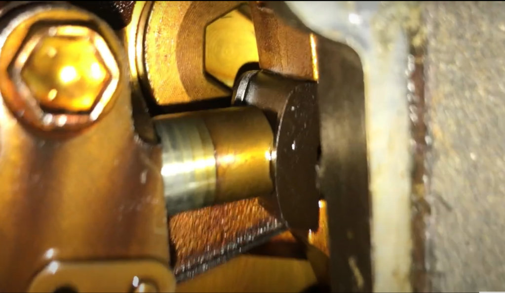

  12. Oct 23, 2024 at 7:43 AM
    #32
    Jimmyh
    Jimmyh Well-Known Member
    May 16, 2012
    #78991
    14,262
    SC
    2012 Prerunner SR5
    Is it possible that one of the phaser ears for the VVT is broken and rattling around inside. I've seen them broken before.
    That might have been the issue in the first place
