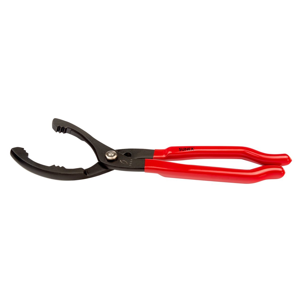

    When you are on your back looking up at the filter with your left hand turn filter counterclockwise to remove. These angled oil filter pliers work nicely, too40A0A950-9FBB-4AA1-8FD3-C78D3B6F5AF9.jpg

    Yep. I recommend this all the time and it works great. There is no access to use pliers or the old style strap wrenches on any vehicle I've owned in 20 years.
