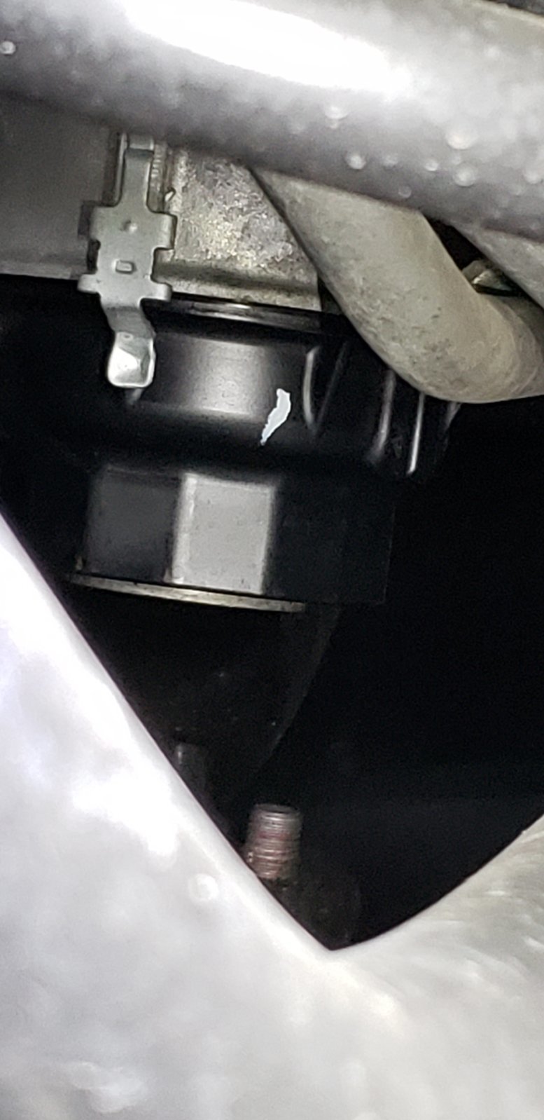

    If you don't have a torque wrench or don't want to whip it out each time, here's where the cap and tabs should end up in relation to the metal retainer.
    When I did my first change, trying to get the metal drain plug started spinning the housing so these are not tight at all coming out of the factory.
    Edit: Those of you who have issues; where are the plastic tabs/ribs compared to the metal retainer?
