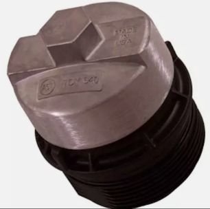

    completely stock here. 1st time was a nightmare, was afraid i'd break it due to dealer over tightening.
    needed breaker bar. fortunately it came off in one piece and i tighten it with a torque wrench. i believe it does get harder to remove after being installed but not overly so. i would need a ratchet to tighten it so might as well use a small torque wrench and pull til it goes click. 18 ftlbs. no ear breakers here. got it off ebay for 8 bucks in a bidding war. usually changed cold, sometimes warm, never hot.
    usually requires a couple taps to get the wrench to release it. not a problem.

    Got the plastic filter housing off, didn't take much using the Motivx tool. I could see on the plastic housing where the ears had been distorted from previous oil changes. I decided not to install the metal filter housing at this time; I'm going to hold onto it as a spare in case the Tacoma or my other two 4Runners need it during a future oil change. Torqued it down to 18 ft/lbs and called it good.
