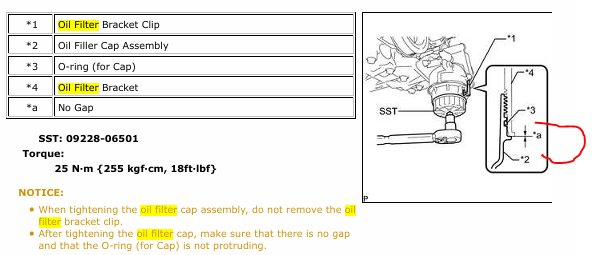

    KY
    Canadian Caber and BillF1564 like this.

    Look carefully at the design of the housing and the cap. You suppose to stop cranking when 2 surfaces are met. No need to torque

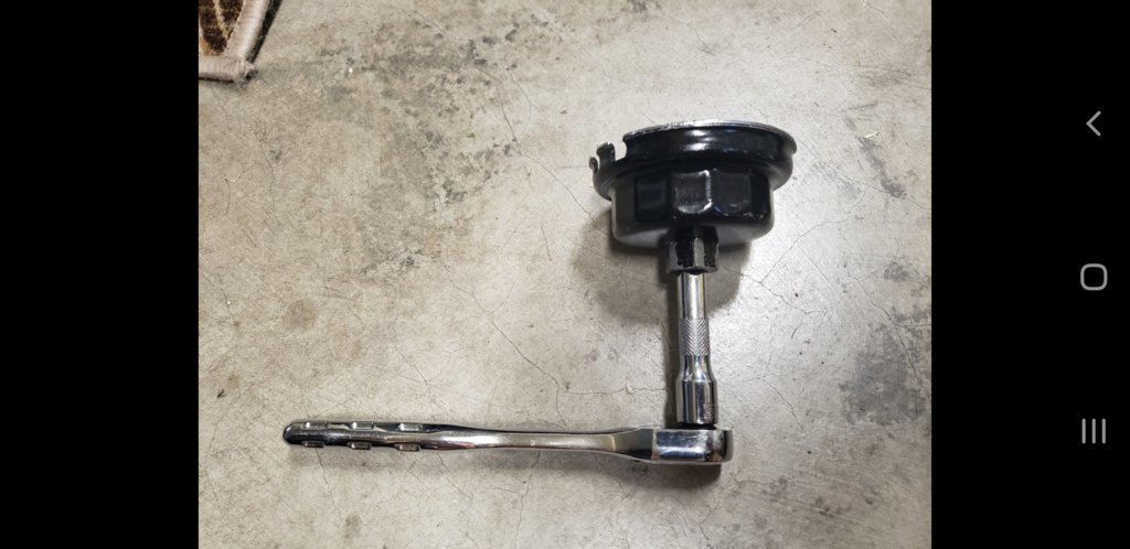

    Yeah, I learned to be mad at myself for over-tightening with my hands.
    The darn housing things expands!
    Definitely put a little dab of new oil on the o-ring on the housing unit...and put o-ring in the correct slotted area:
    Also, I use a 27mm socket on the housing wrench (circled) instead of the 3/8 slot in the middle and a breaker bar...makes for much easier twist off.
    Yes, I keep my composite housing as a back-up. :thumbsup:
