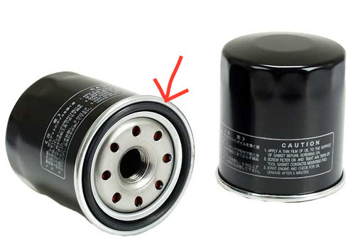

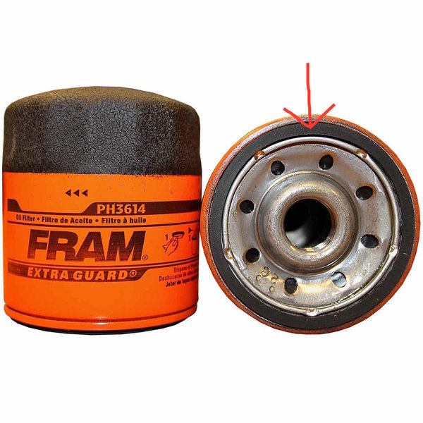

    Mainly because, unlike most aftermarket filters, Toyota filters seat against the block with the metal of the filter. Aftermarket filters seat mostly with a rubber seal.

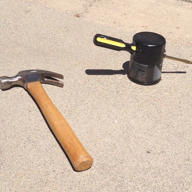

    My 1st oil change after I bought it from the dealer.
    Next oil change I bought that clamping style socket type one above. I use the Fram or mobile 1 oil filters now too.
    10613020_10152309316348568_7171960227354_e46b94a701accd6c3b1f44ade3683605737ba846.jpg
