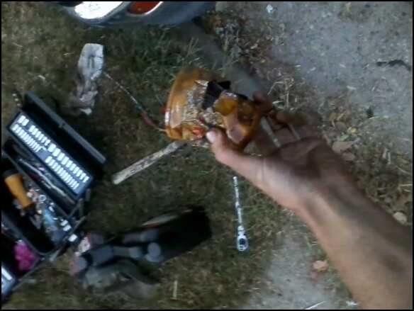

    I wonder if the filter is put on it before the engine is actually in the truck. When I rebuilt my engine, (2.4L, in a 1996) the filter was put on with the engine still on the stand, so it got put on very tight, even though it was done by hand, because it was easy to get to instead of the limited movement you have when under a vehicle. So it was very tight. When I did my first oil change at 3000 miles, it took me like 45 minutes to get it to come off! Tried a strap wrench, a giant set of channel locks, and the screwdriver trick.

    Grabbing the filter in the middle of the body is the weakest, worst spot. The crown of the filter is the strongest area, that's why when you see these tools that are recommended they all lock in at the crown/top of the filter.

    Yes. I realized that after I fought that filter forever... after I had destroyed it. :laugh:
