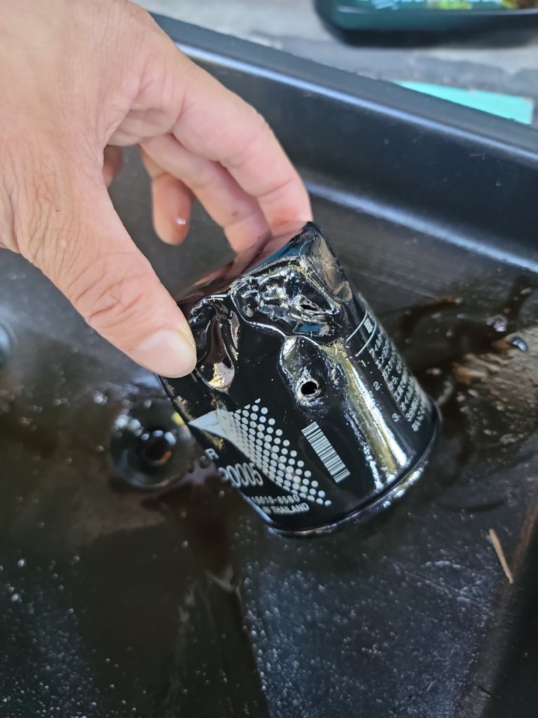

    Here's how fuked the filter was when I finally got it off.fc59df50-74a5-4a31-b3d6-5161607791bc.jpg

    Drill a small hole then take a screw driver or similar and it will come off easy peasy

    Tried that. my drill hole is prominent in the pic as well. :) There's just so little space to work with there...

    holy hell what happened to the top lol
    If you drill it at an angle (doesn’t have to go all the way thru) you can fit an screw driver or a socket extension in it all you need is it for it to move a millimeter to break it loose

    Haha a combination of using the plier style tool, and the strap wrench... sigh. i couldn't get a big enough screwdriver in there tbh. I had a small one, but it was too thin and was bending.. This was a fun oil change. lmao
