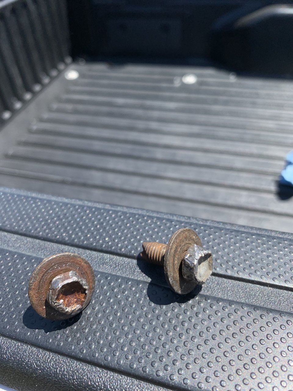

    if you don't have access to "many" tools I think you aren't going to get that off yourself. is there an old guy in your neighborhood that knows how to work on stuff? that would be the cheapest & quickest option at this point. looking at the pictures the washer & bolt head are tight against the plate, so it doesn't look like it was cross threaded - and that's good. if you have access to a grinder grind the head of the bolts off. do not use a cutting wheel. when you grind it bear down hard on the head of the bolt so it glows red. hopefully that will expand the threads and contract enough to break the bond. the bottom line is you need remove the bolt head. looking at the pictures I think the bolt head & washers and not the threads is where it's stuck. once the head is gone get some oil on the threads - pull the dipstick and wipe some oil off with your fingers and wipe it onto threads. let it soak for a couple of days - your truck will work fine without a skidplate - and try the visegrips again. I bet the bolt comes right out. and if not it's time to drill and / or cut. that is something that needs to be done on a lift.

    thanks everyone for the help and support, came off after a good two day soak in PB and a GOOD socket on an impact. 12 point socket did the trick.

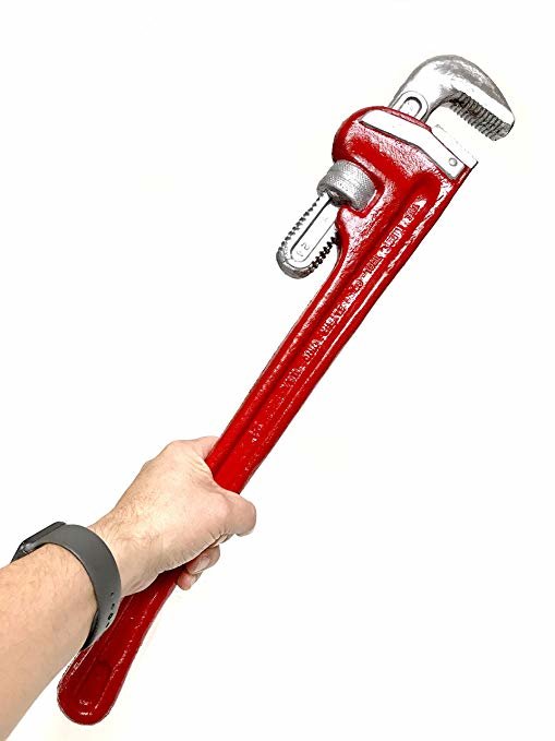

    pipe wrench.jpg Since you don't seem to have access to the level of heat needed, ask a plumber friend to borrow his BF pipe wrench, WD-40 it for 2 days and then use the wrench. Been there, done that. It has saved my bacon a couple of times.
