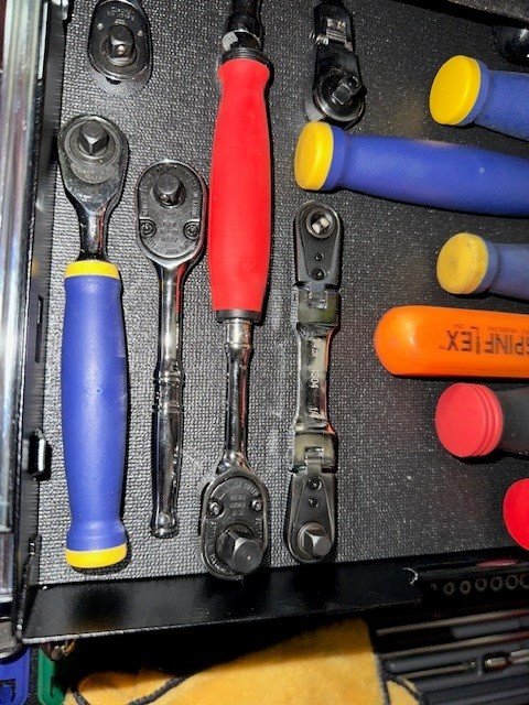

    Plugs are completely a feel game. I never use a hammer or anything but also have rarely had one that gave me any trouble. The Tacoma is pretty friendly to do plugs on so it is a good vehicle to tackle to learn. Probably the worst I have done is an 07 Ford 5.4. Those are a nightmare and best I ever got on those was breaking 2 then using a special tool to remove. My mother in laws 06 SS Trailblazer with a 6.0 was about a 4 hour job as the book says to actually lift the body off the frame or pull the motor. One thing I have found is the right tool for the job goes a long way on doing plugs. An extension that locks to the socket is nice to have for those plugs that are deep in the head and a good set of sockets goes a long way. Not ones where the rubber insert stays on the plug. The magnetic ones are awesome. I got this set from VIM tools and absolutely love them.
    https://www.summitracing.com/parts/VIM-MSPM100 These have a swivel that is spring loaded so it returns to center but will flex when you need it to. Works great and these have the magnetic core like the Snap On plug sockets so they slip on and off the plug but also hold it securely. This is the best set I have found for the price point.
    This is a nice locking extension to have for those 4 bangers with the plug 12" deep in the head. https://www.napaonline.com/en/p/CHTEXTL3812
    My absolute go to ratchet for doing plugs is the Snap On 3/8 ratchet on the 1/4 frame. Handy little wrench. The one with the red handle in the pic.
