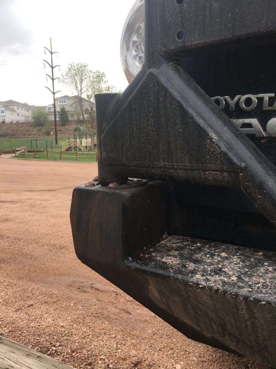

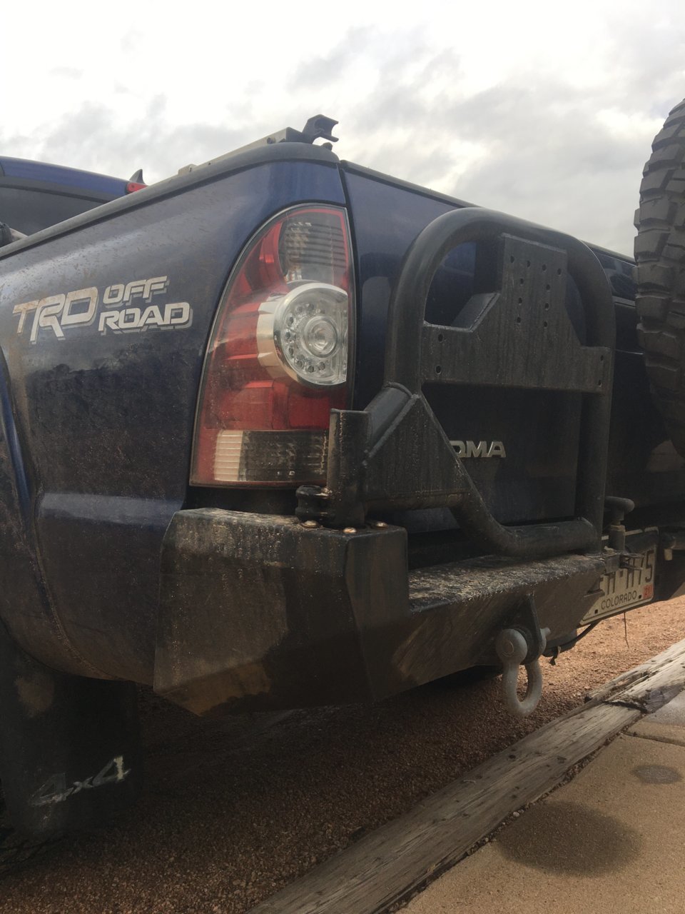

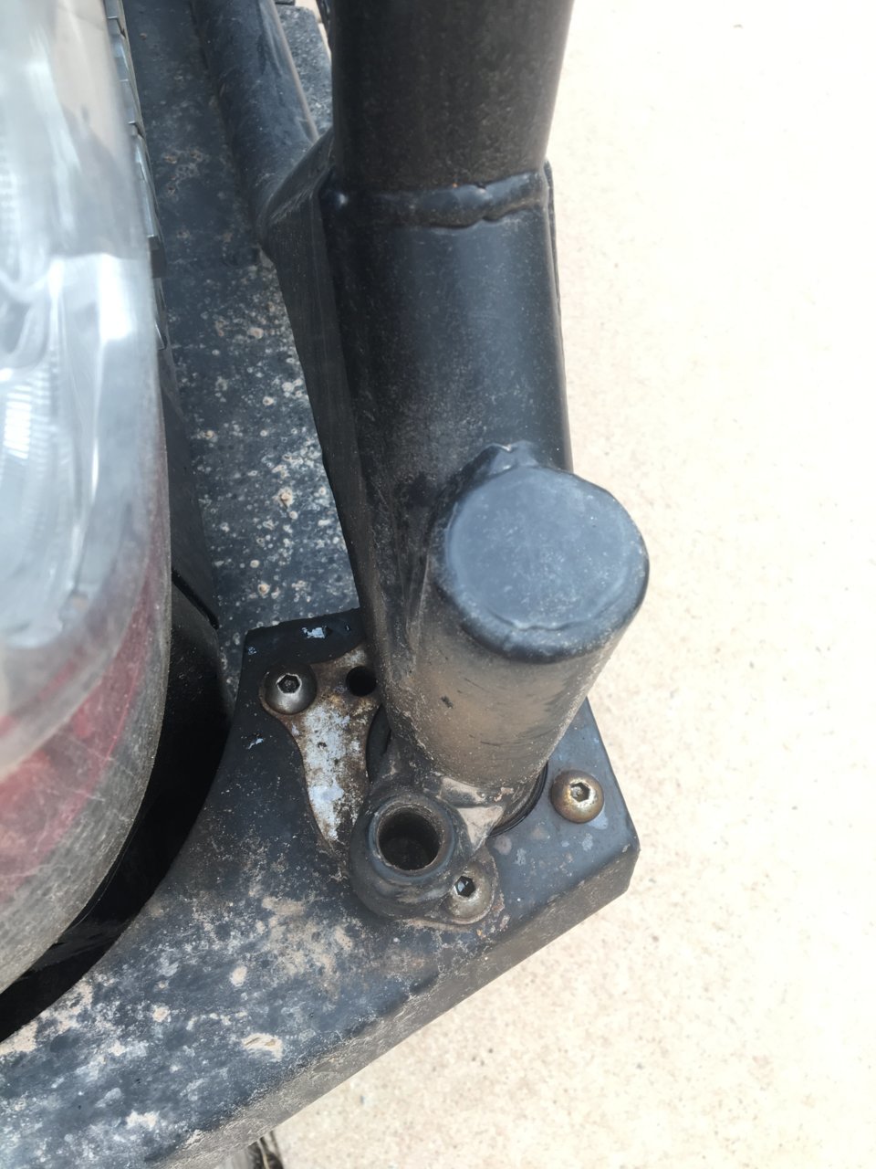

    Thanks for the replies. Here are a few photos of where the arms attach to the bumper.
    7F0A3444-818B-4890-AE15-2C2684139767.jpg AE1179E7-ABC8-4984-97A2-47CAE1AF152B.jpg D273703F-D762-49FC-82FA-2DDD2E5B7D4D.jpg

    Yep. That’s the same as mine. It has bushings not bearings in there.
