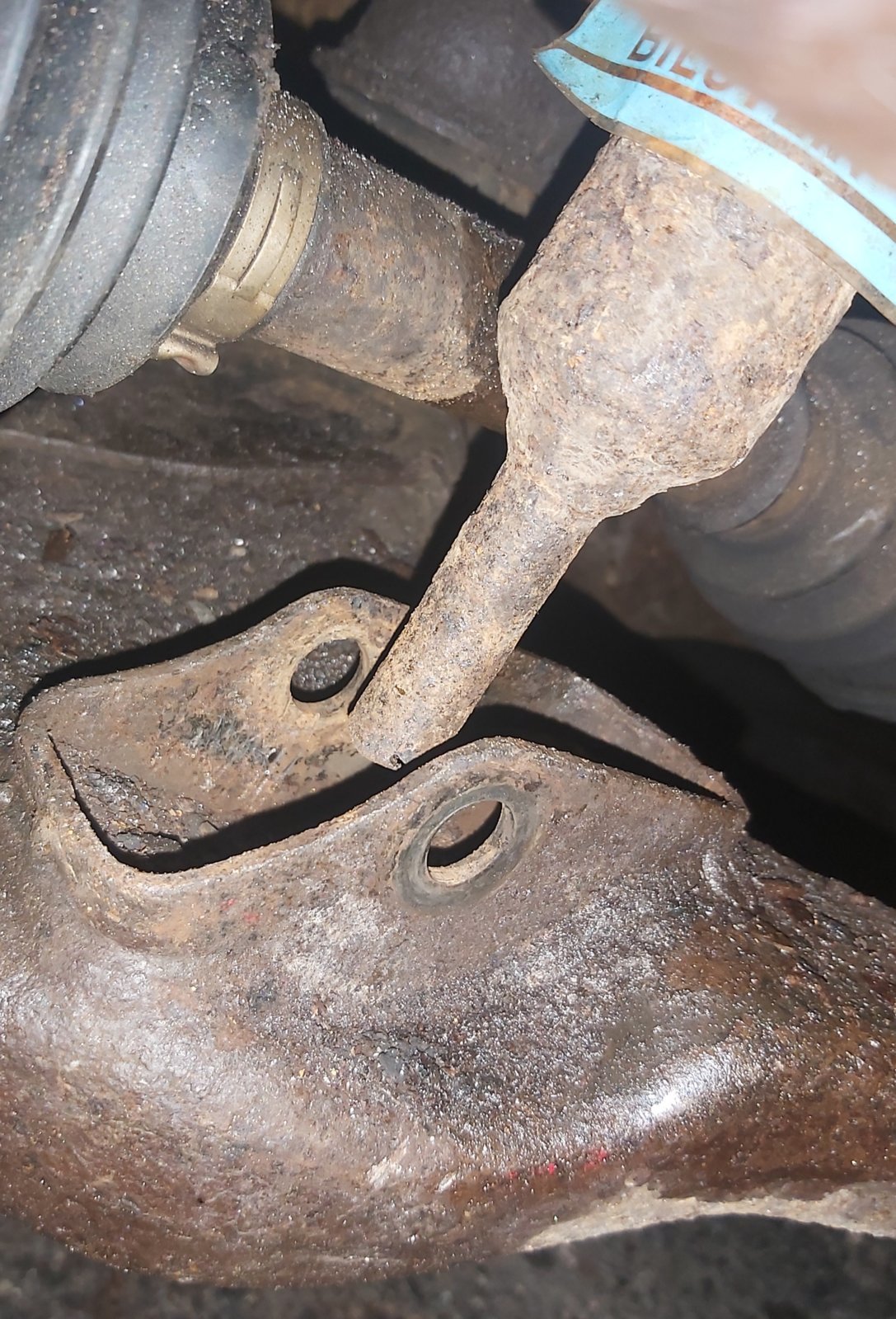

    To be more clear the, where the mount seats up against the frame, it appears to be completely seized up.IMG_1103.jpg Everything underneath is disconnected, it should just plop on out....it should... Any ideas are appreciated. if any more pics are needed ill take em

    cant remember how I specifically did it but I think I reattached the shocks lower mount on my 4runner, and then jacked down on the LCA to pull the fucker out. Gave out a nice bang when it unseized.

    You saved my weekend. Worked like a charm.:bowdown:IMG_1106.jpg

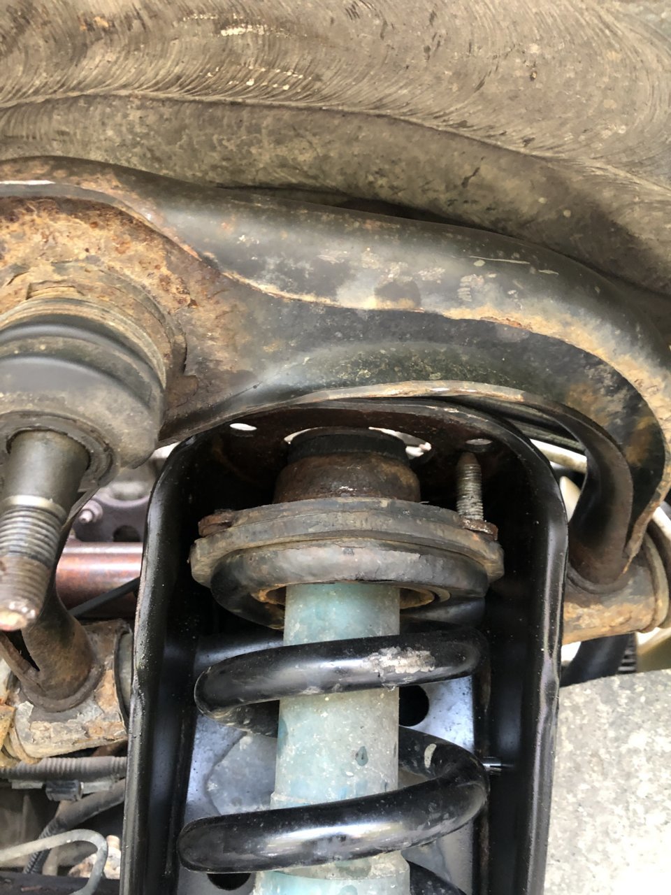

    Load a picture of what the lower part of the shock you cut looks like
    EDIT: put a pipe wrench or vise grips on the chrome shock rod as tight as you can and then hit it with a big hammer to drive the whole assembly down and away from the upper mount.

    ^this
    Pictures will help us help you.

    Ask and thou shall receive. :)

    The shock extended when the lower control arm dropped and I guessed it was why the shock didn't drop out. So I chopped off the end
    I guessed wrong!

    Try vise grip or pipe wrench on chrome shaft and hammer the tool down

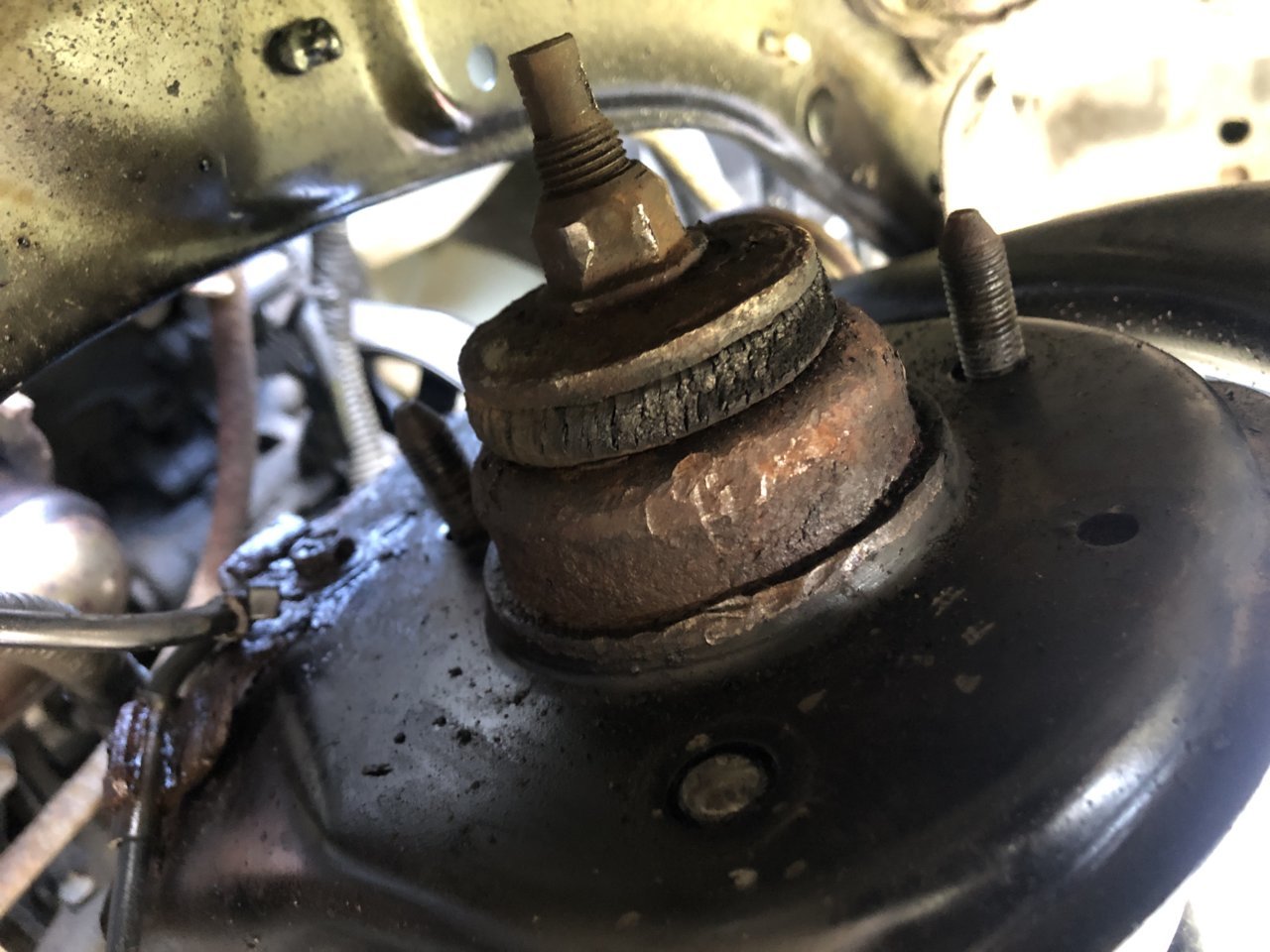

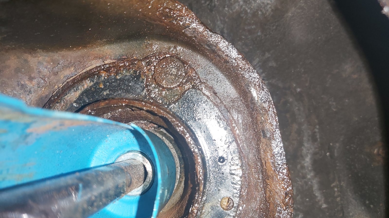

    Can you take a pic looking at the top of the coilover so we can see the bolts? Looking at the amount of rust I'm guessing the coilover is just seized. How are you applying heat, propane or MAP? What are you hammering with? I would recommend a heavy ball peen.

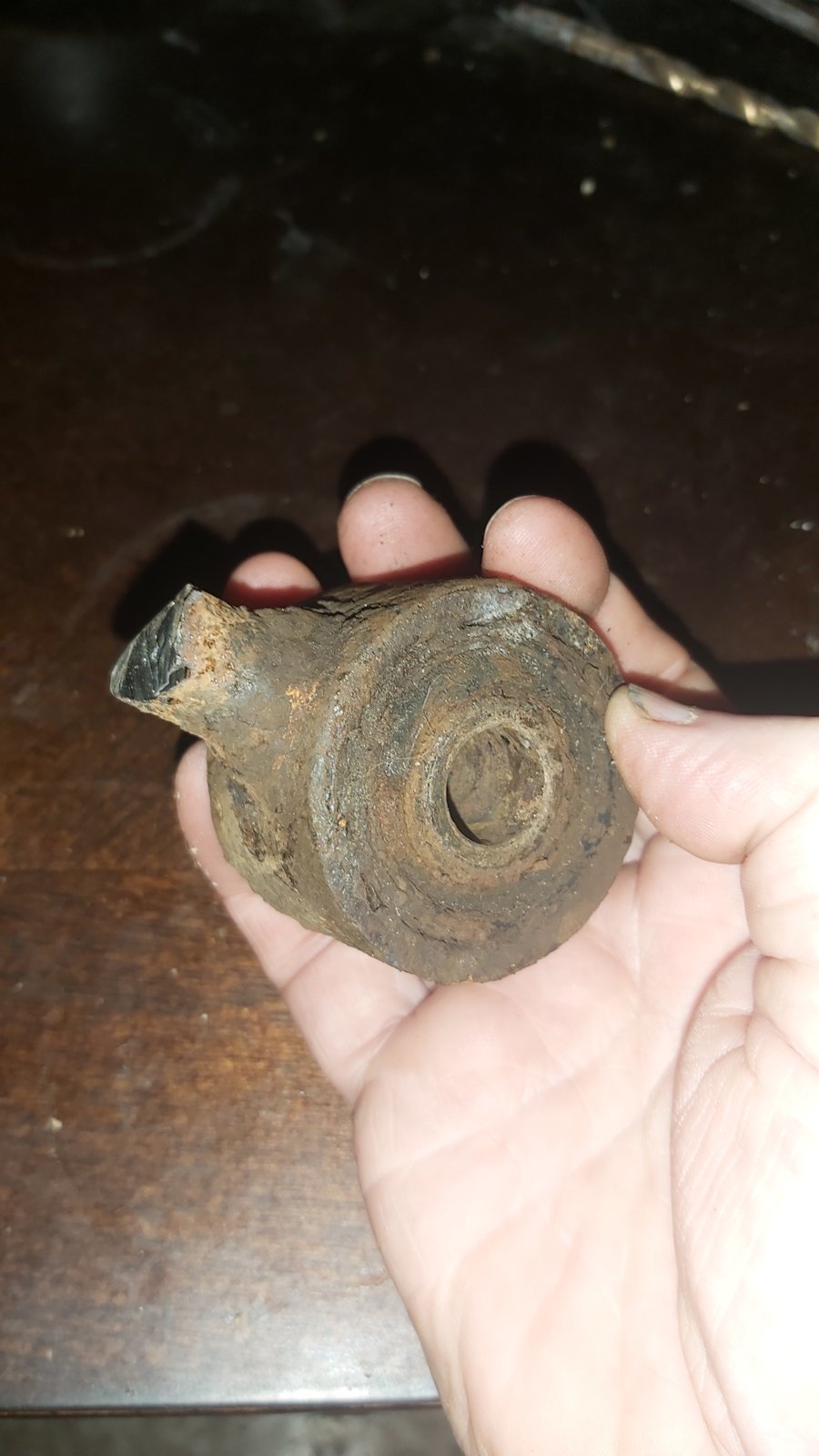

    I finally got the #^&% strut out.
    I tried the vice on the rod, but no luck.
    Long story short, I used a torch on the underside of the bracket, bent the top of the strut down, then put an oscillating saw to strut above the bends. A few seconds of vibration later, it dropped!
    Maybe my experience will help someone else.
