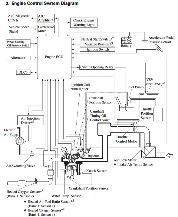

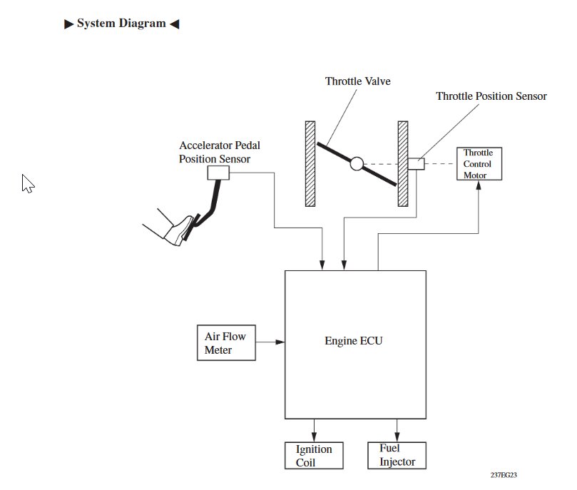

    This is a good read about the 1TR-FE and 2TR-FE engines:
    https://www.google.com/url?sa=t&rct=j&q=&esrc=s&source=web&cd=4&ved=0ahUKEwjW2c6V1oDMAhVK1CYKHdx2Bg4QFggzMAM&url=https://www.tradebit.com/usr/wisark/pub/9003/Toyota_Hilux_Service_Repair_Manual_Complete_INFO.pdf&usg=AFQjCNF0yftMIU6cMmxpQtWU6qnzYwJVhw&cad=rja
    See page 14 of 29 in the PDF
    6. ETCS-i (Electronic Throttle Control System-i)
    General
    1. The ETCS-i is used, providing excellent throttle control in all the operating ranges. The accelerator cable has been discontinued, and an accelerator pedal position sensor has been provided on the accelerator pedal.
    2. In the conventional throttle body, the throttle valve opening is determined invariably by the amount of the accelerator pedal effort. In contrast, the ETCS-i uses the engine ECU to calculate the optimal throttle valve opening that is appropriate for the respective driving condition and uses a throttle control motor to control the opening.
    3. The ETCS-i controls the ISC (Idle Speed Control) system.
    4. In case of an abnormal condition, this system transfers to the limp mode.

    Engine Control System:
