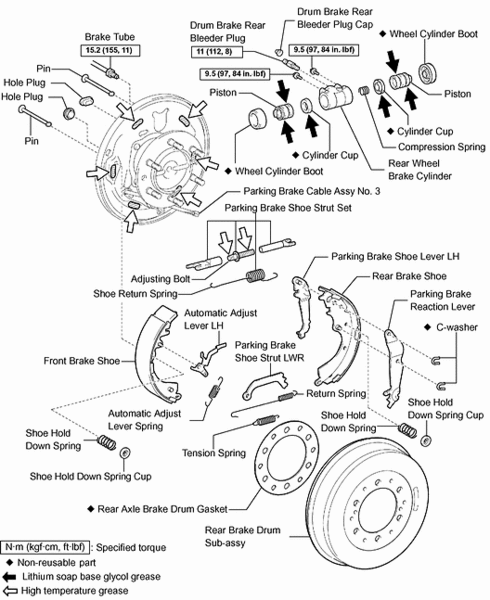

    Ok, so there's a part on the bottom picture you posted that looks exactly like the brass colored part that came out last night. Any idea how to replace this if I get a new one? The one that came out was bent.

    OK, PLEASE PLEASE PLEASE do not get offended here. I am saying this only because of safety concerns, and I am not by any means bullshitting you here. DO NOT DRIVE THAT TRUCK! Call a tow truck and get it towed to a shop to get this fixed. That "little brass piece" is part of the cylinder that does your automatic adjusting. Without that piece the adjuster can slip loose and fall into the drum. Then it could get lodged/stuck and lock up that wheel, causing you to have an accident! I'm not playing around here, get that thing fixed before you EVER put it on the road. Driving a truck with those pieces missing, you pose a danger to yourself, and to others on the road.
    This is a break down of the 2005 Tacoma drum brake parts and assembly.
    You can buy the hardware kits at Advance Auto:
    Spring and pin kit 17263
    Adjuster Kit 12560
