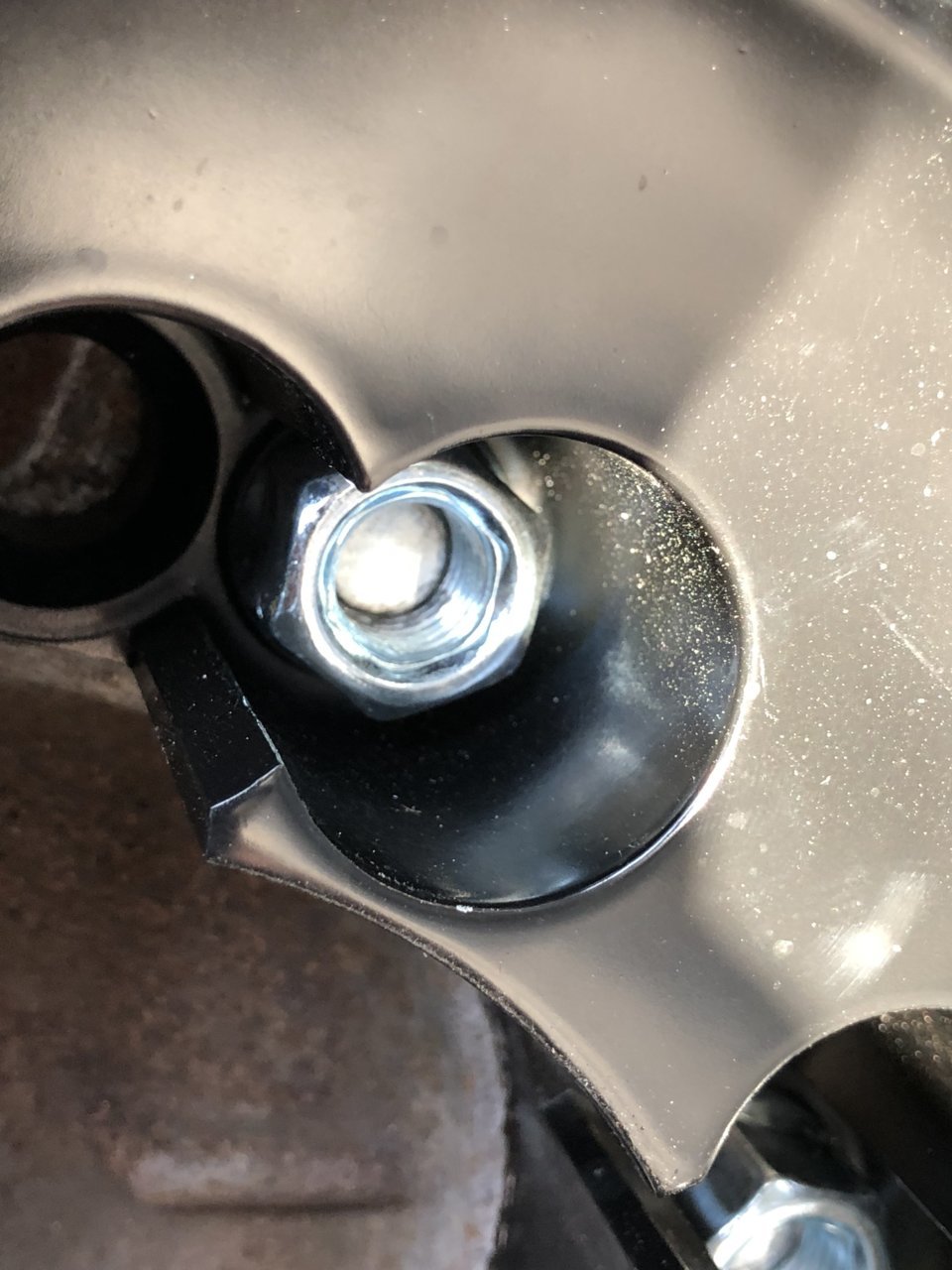

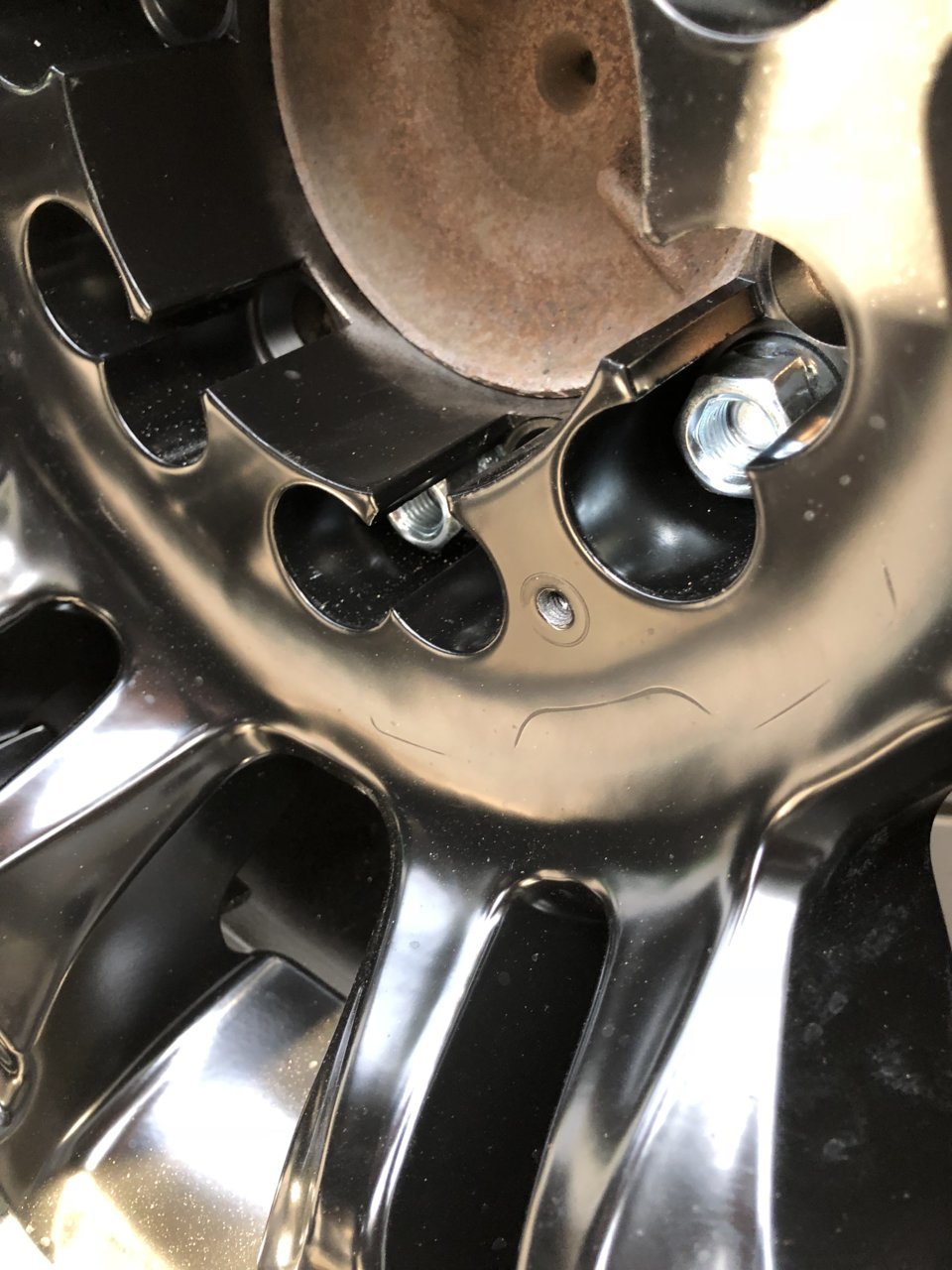

    I’m looking to find extended wheel studs to accommodate my aftermarket wheels. The stock studs are only given me a bite of maybe 2 threads which isn’t good at all.. I’ve called 4 wheel parts, they don’t carry Tacoma studs. I’ve called summit and they only have stock ones. Anybody else with this problem can tell me where they got longer studs?

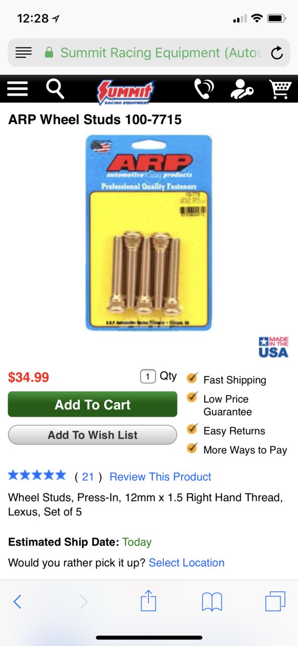

    I used longer studs from an old Lexus is300 I got from summit. Only came in a pack of 5, have to order an extra pack

    CE7F2F7F-6CCF-449C-8E2D-73C068669125.jpg 6A36FC9C-F7FF-41E9-B724-44D5B7446A28.jpg
    Are these the ones you got ?

    They look like it. It was about 6 years ago when I installed them. Make sure the knurl diameter is the same as a taco stud and it will fit. I still have the box in my old toolbox but it’s in storage on the other side of the city, but they look like them.

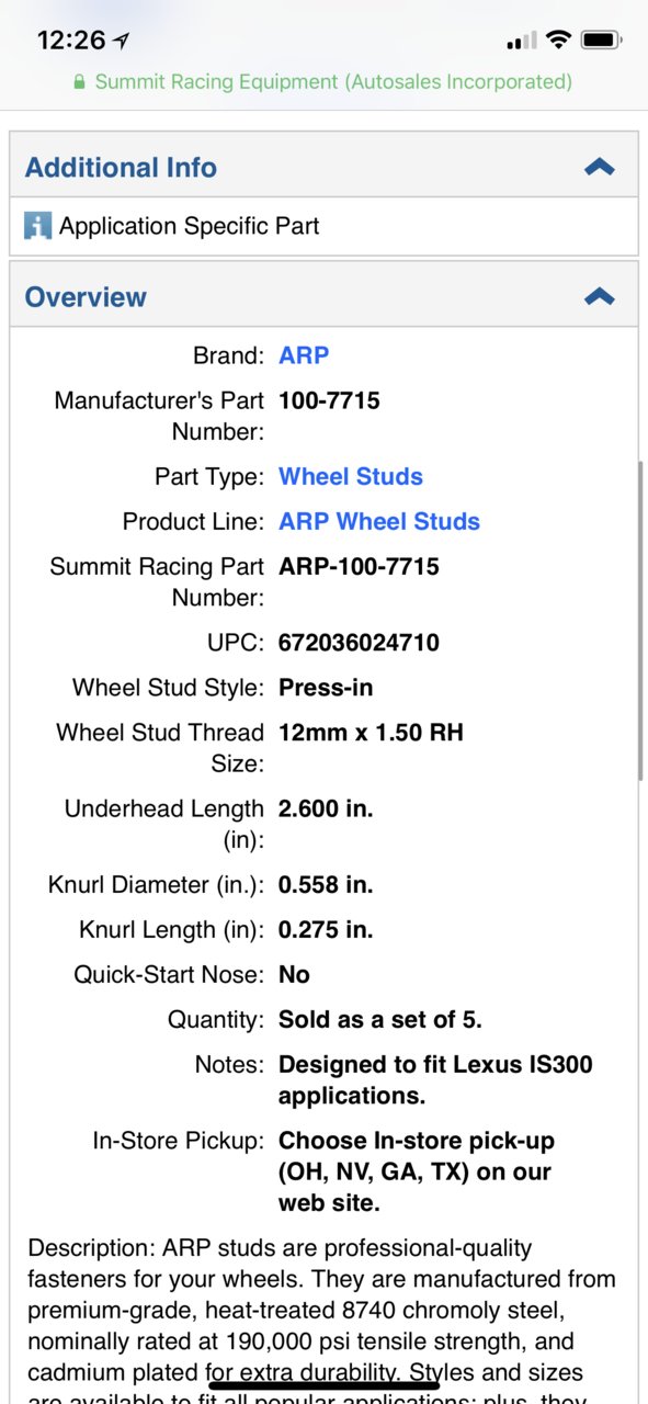

    You could try Jegs too or even Amazon. The stock size is;
    M12-1.50 Serrated Wheel Stud - 14.20mm Knurl, 40mm Length
    Figure out the length you need and search by the size you need rather than looking for toyota tacoma studs.

    The knurl diameter for the Tacoma is .559 and these are .558, it shouldn’t make that much difference being off 1,000 of an inch you think?

    Don’t think it would. When I put mine in I had to press them in, it’s not like they fell right in and spun freely, if you are feeling really paranoid about that 1000th of an inch you can always tack weld the back of the stud to the hub.

    I have fuel vapor wheels if that makes a difference 13148550-B7BA-47B6-A26B-24B491CB9758.jpg . 1D79EA2F-D727-4A3F-924B-D1CB7C704AD1.jpg That’s all I’m getting

    Those Lexus studs will take care of that issue. That’s just asking to rip threads off the studs.
