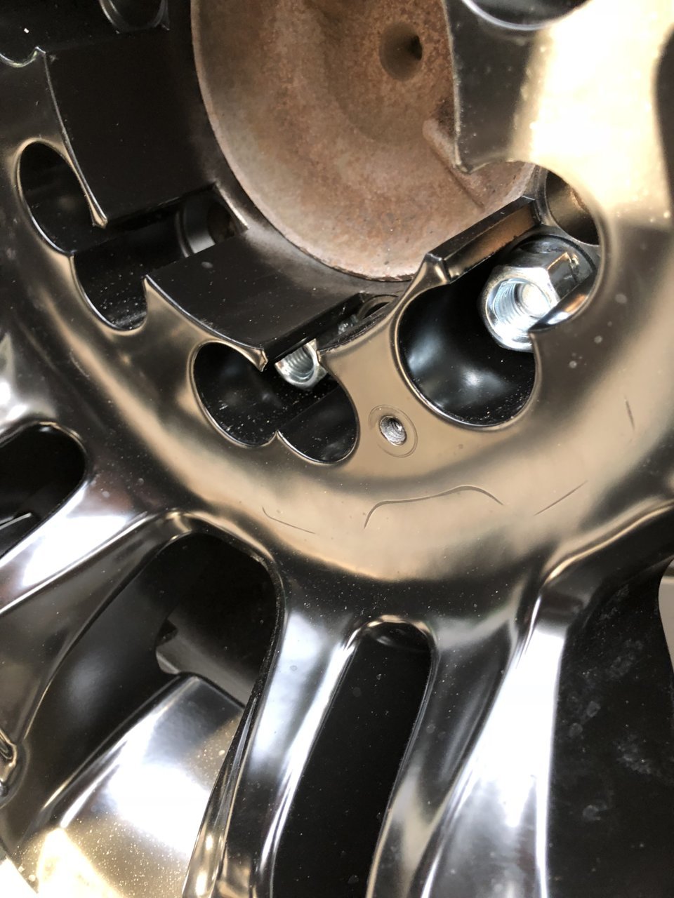

    No it’s actually a lug centric wheel as well. It’s just not an extended threat like the one he posted for sale

    Their website isn't much help, just states "conical". I'm going to assume that ET style lug nuts may not be suitable for this rim. And that you may indeed need to install longer wheel studs as previously stated to achieve proper lug nut thread engagement.

    Fuel vapor57DA0EB2-A1B3-461F-B4E8-96C56775B5D9.jpgCA4D531B-E842-4642-B95B-F51667085214.jpg

    Op could go to a tire shop, most sell sets of lug nuts... have put on. done
