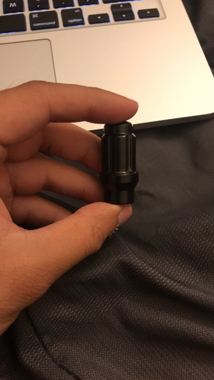

    Gotcha. Are these the acorn style you were talking about? When I called Method Race Wheels and told them what I bought, they said these would work.73B42A36-FFE5-4D19-9E8B-AB04A712443B.jpg

    They do look near identical to the lug nuts Method sells.

    Those are the ET lugs. You got the correct ones.

    Yeah good 2 go. Not sure what wtf Costco was smoking.
