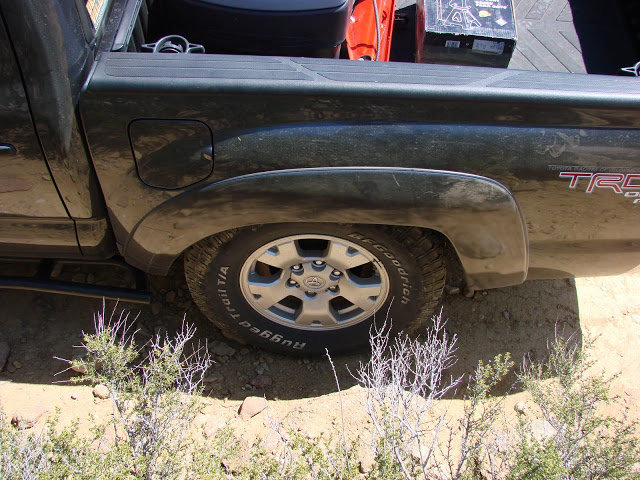

    Below is a pic of the factory rubber, i'm just wondering if they'll rub or will I have to make any adjustments in the front or the rear.
    If you have any pics of your 33" tires stuffed in the rear, please post them up.

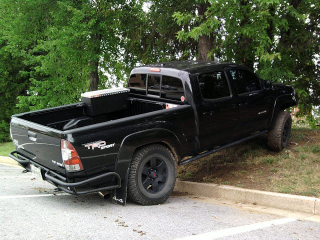

    check my pics im running 285/70-17 (33's) almost 3" lift no problems

    285/70R17s with Dakar Leaf Pack - no rubbing --barely

    Thanks for the pic Viper, it helps to see it :)

    Based on your post of wanting to run 255/85R16 (33.067" diameter), and mine being at 32.7", I think you will clear the rear. Since you are running a narrow tire, the front should be no issue at all. I barely rub the upper control arm at full lock and stuffed.
    For the record, I did break a bunch of tabs off of my front fender flares when wheeling though. I have removed the fronts and live with the holes now. They rubbed when stuffed and eventually I broke some tabs off. I have become accustomed to the way it looks with the holes and wouldn't go back now.
