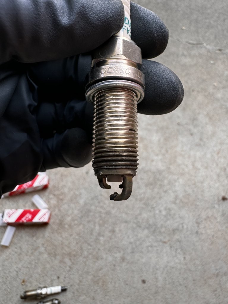

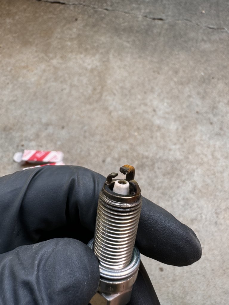

    I was really hesitant to do this but I pulled the intake manifold off to investigate a little. I did not see any problems with the harness. I went ahead and cut the CMP sensor plug off and spliced in a new replacement. And guess what?!? That did NOT fix my issue.
    I did a little more searching and came across a post on TW from a guy with a similar issue… had new plugs installed that ran well for a few hundred miles and then started to stumble and hesitate. His conclusion was that the shop installed the incorrect spark plugs.
    so I pulled a plug and it did not look good. It wasn’t even the correct part number!
    The first spark plug change I did 60k miles ago I searched eBay for 90919-01263 (or denso FK20HBR8) and bought a set. This time I did the same thing - searched for a set of 90919-01263 and found a very reasonable set for $65. They arrived in boxes that looked just like genuine parts boxes. I thought i scored big on the $65 price but apparently I was duped into purchasing a set of counterfeit plugs as I learned in this video https://youtu.be/FVA4RYql9KU?si=vK7PwjJslRZ6RM-W
    1200 miles later they were trashed.
    So I stopped by the dealer today and picked up a fresh set, installed them and good as new. I wasted about 8 hours of my life chasing this problem.
