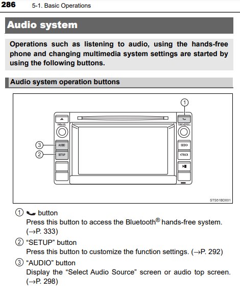

    I think it’s an option in the settings pages through the radio to have all doors unlock when opening the drivers door.

    It is buried in the settings on the radio. I have changed it around.

    Yep you can change the settings through the screen, I’d get the real key with lock/unlock/panic. I installed the pop n lock for the tailgate, it works off the fob, love the convenience but if you want to disable the Autolock you need to go into setup

    !.) Being a MANUAL transmission I don't have Park, Neutral, Drive. So it does matter.
    I also have the Basic Entune Audio system.
    See page 291 + on the pdf owner's manual here: https://assets.sia.toyota.com/publications/en/om-s/OM04013U/pdf/OM04013U.pdf
    In a nutshell, I can adjust the audio settings, display settings, clock, voice settings, bluetooth, phone settings, there is no accommodation for adjusting auto lock or other truck-specific controls. (At least that I've been able to find.)
