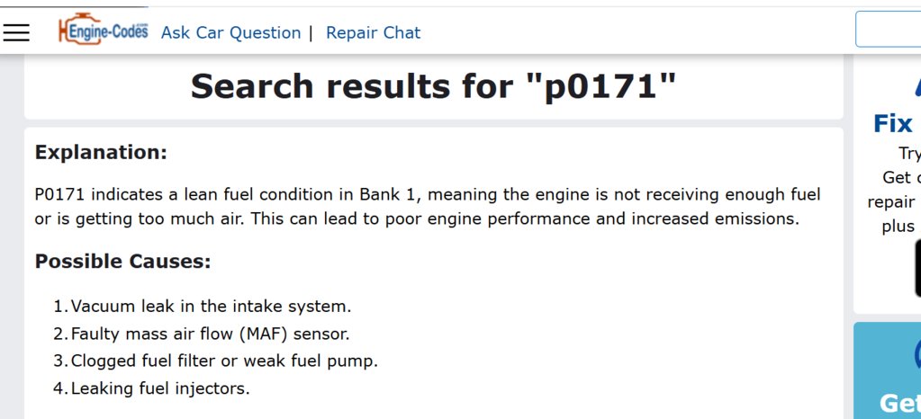

    The p0171 could be caused by a intake vacuum leak somewhere

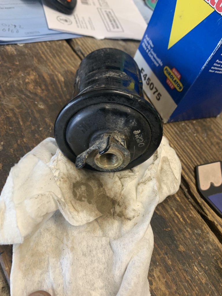

    Also
    This was (what I expected) was original FF
    Yuck
