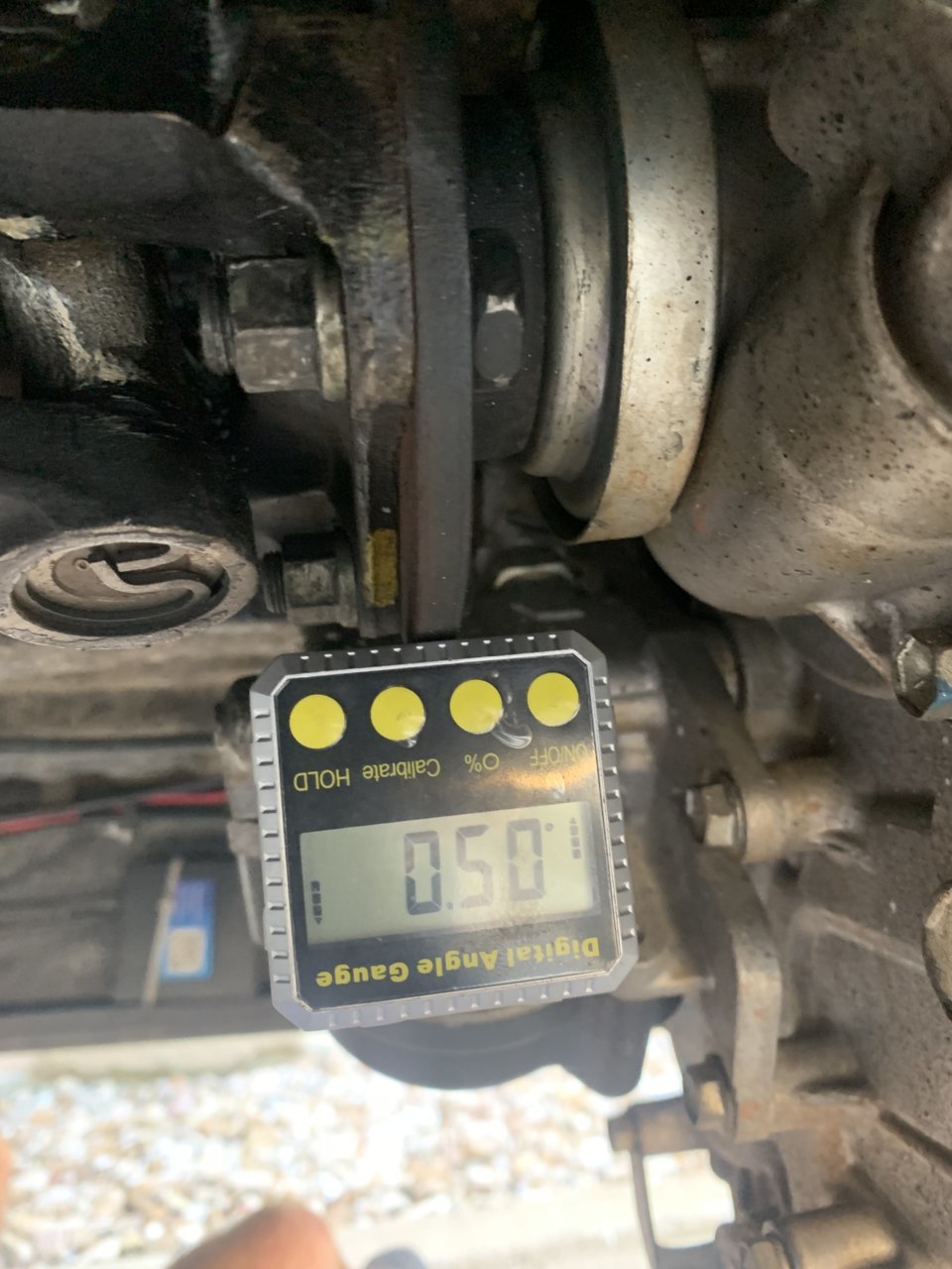

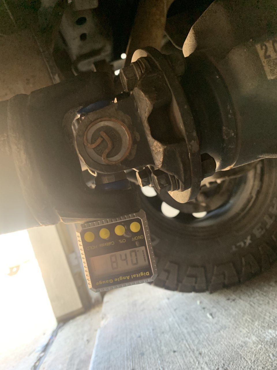

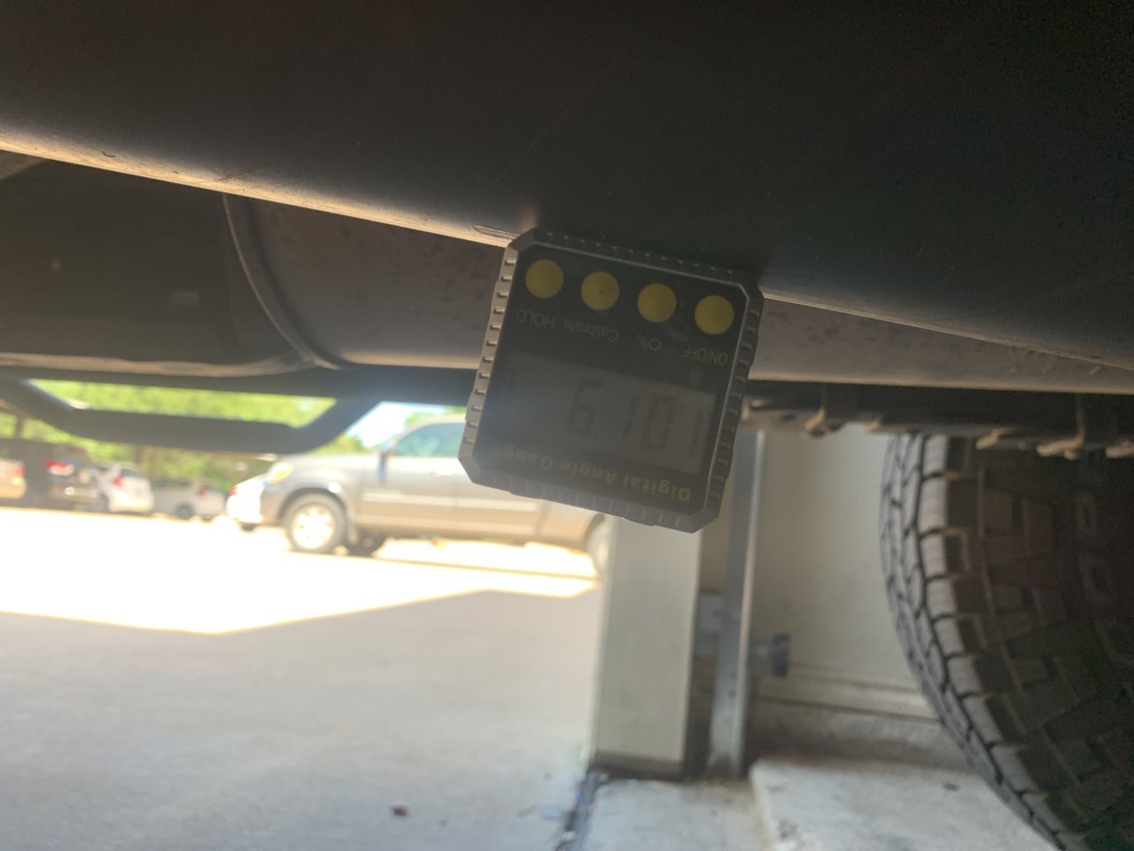

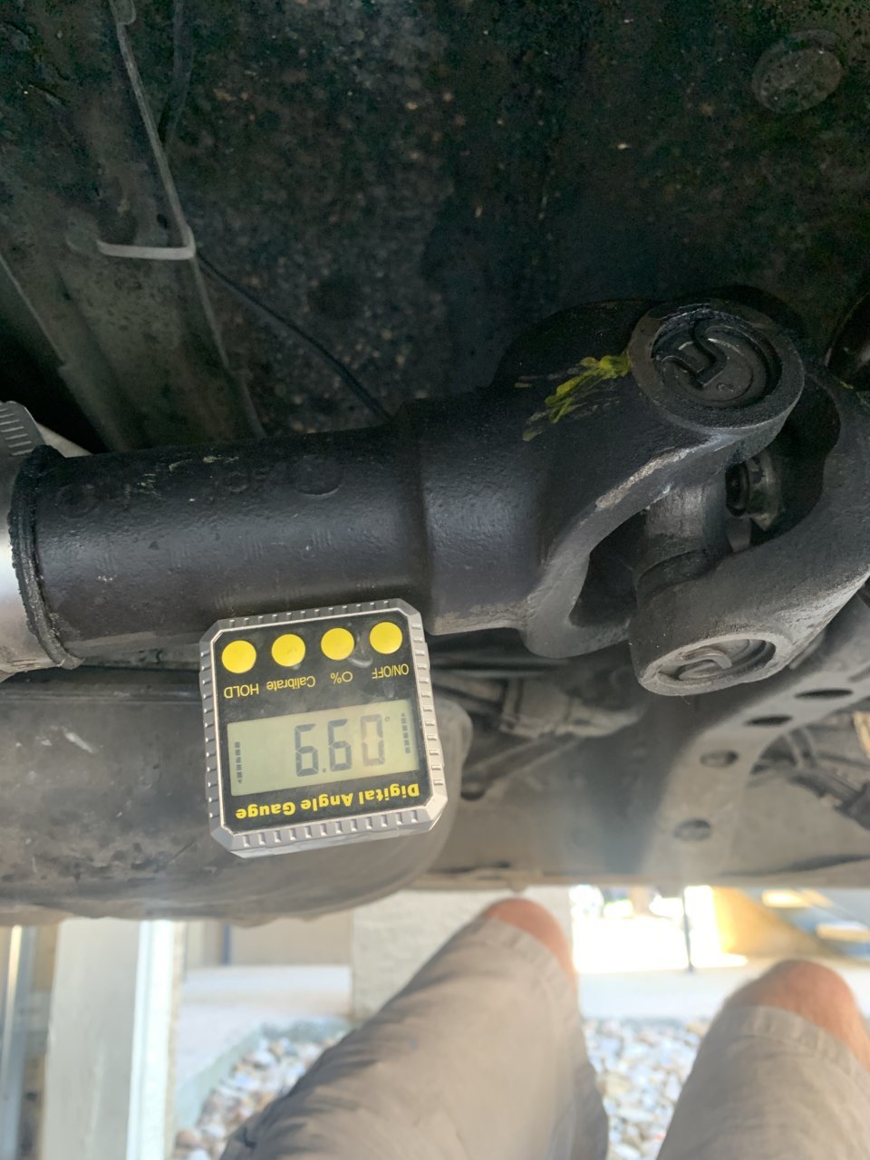

    How are your drive line angles?

    I dont remember exactly but they were under 3deg. Ill throw the angle finder on it again tomorrow and give exact numbers

    The t case flange and 3rd member flange should be parallel.

    I am pretty certain they were within 1deg of being parallel but have to get new numbers since i installed the leaf pack to be certain
