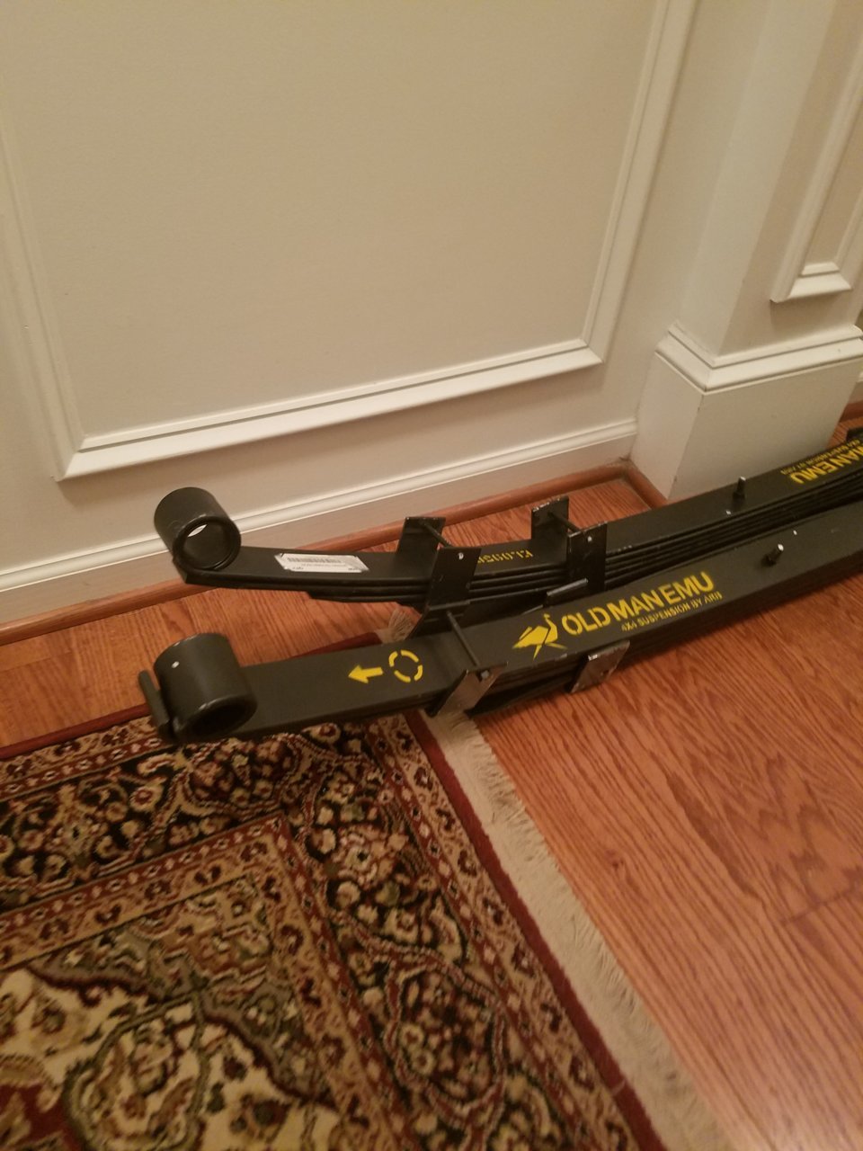

    So I bought some OME medium Dakars and they arrived this week. One thing thing that surprises me: in every pic of them I have seen before I have seen a plus sign `+' followed by an arrow, I guess to indicate which end of the leaf pack should point toward the front of the truck. But mine have an `O' followed by an arrow:
    I assume that is still pointing toward the end toward the front of the truck? Does anyone know what the `O' versus `+' means?
    Thanks

    It has to do with the tolerances allowed for the spring to pass I think. + is a little higher but still within a desired tolerance. 0 and -

    Oh and arrow to the front for sure

    So then `O' is in the middle of the tolerance range? Is that good or bad?

    Yep, what he said. They’ll send you two at random and they may be + O or -
    If you have one higher than the other, put that one on the drivers side.

    It's all good either way

    Both if mine are 0
