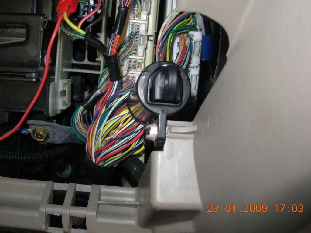

    Ok i just start from the bottom first(the one on the glove box) then lift it just enough to connect the dampener to the top hook. i had to play with it for a while but it still works!:notsure:

    I finally put a screw in mine. The screw doesn't have to be big and actually, you want it smaller (with length) so it'll screw into the plastic. All it needs to do is spread open the plastic flare parts to prevent it from coming off.

    I did the same thing to hold mine to the dash.

    this is exactly what i did with mine, too
    works like a champ!

    i seem to remember two post coming out of the dash. is the OP trying to use the correct one? hook up top, stretch out the shaft, snap it onto the bottom post. done. there is plenty of room for even the largest wookie hands.

    I put 3M double sided sticky tape in mine (3 plies). Hasn't fell off since.

    snap in the under dash part 1st, then use a 90 deg bent scribe to hook into lower hole. pull down until the point of the scribe is in the center of the peg and snap it on.

    Just about to say the same thing ... bent piece of clothes hanger works too.

    When the tamper becomes unconnected, the anchor end has to be reconnected by inserting it through the larger opening above the opening where it extends down to the glove box. There is a plastic tip that tamper loop clips onto. The tamper will not clip onto this tip by trying to insert it through the lower opening because of the angle. Hope this helps.
