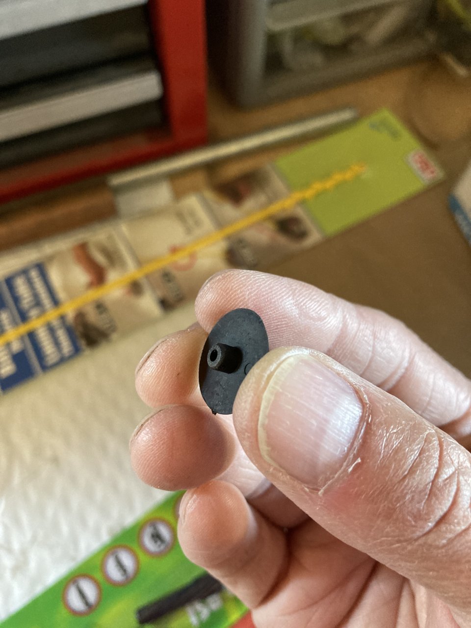

  20. Feb 10, 2021 at 3:57 PM
    #60
    freddyfoxx
    freddyfoxx Active Member
    Jan 28, 2021
    #354297
    26
    Bay Area, CA
    2005, 4Cyl, 5MT, 5lug, fishing mobile
    I used the stub portion of this furniture screw cap. I cut the flat part of it and just used the stub
    scocar likes this.
