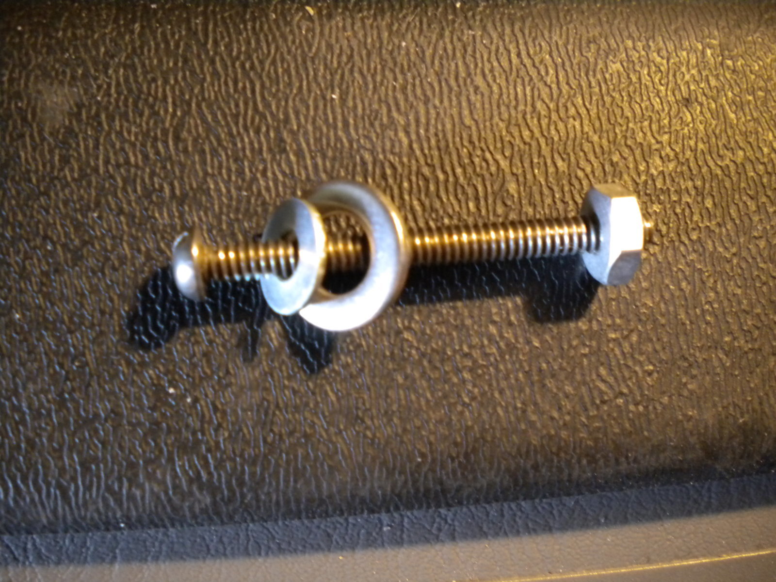

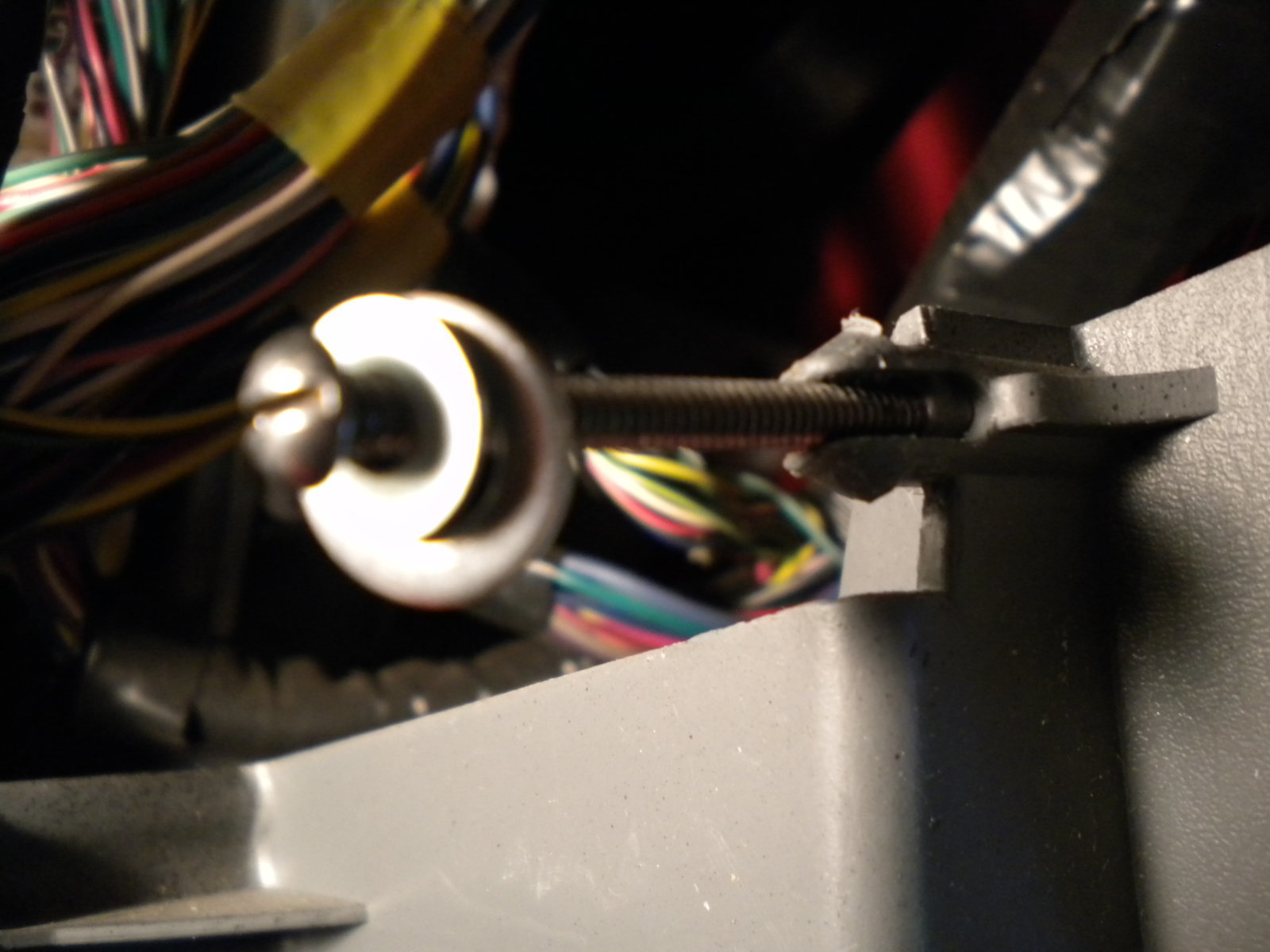

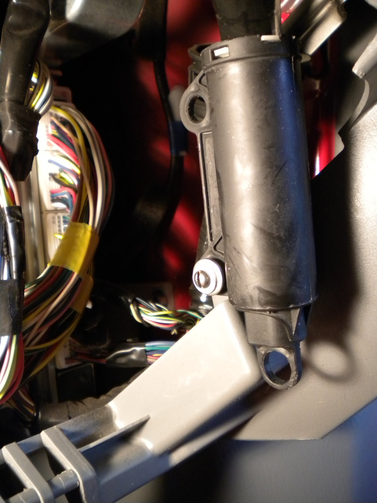

    Fixed this so it won't ever fall off again. Only snap to deal with is the bottom one now.... top snap is permanetly secured with screw. Drill through the top mount tab (avoid hitting any wires) with a 9/64 drill bit, secure dampner (just snug up/don't over tighten) with a 9/64 machine screw 1.5" long / washer/nut. Once glove box is back in lower the dampner and snap back on... that's it. Screw size/length just what i had laying around...
