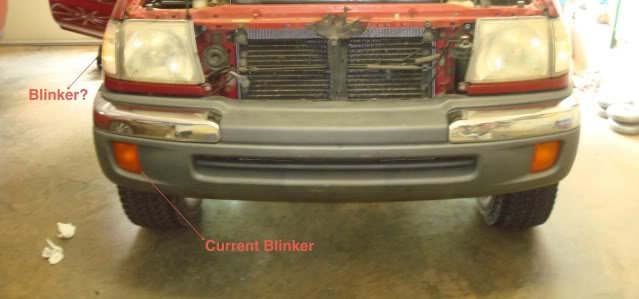

    Hey Y'all,
    Got a very stupid question for ya'll.
    Here is a picture of my truck right now.
    Are the orange lighted area off the headlights blinkers? I think they are, but I have NEVER seen them work.
    My blinkers have always been the ones at the bottom.
    My questions are:
    1) if the orange colored area off my head light is a blinker, can I make that a blinker and get rid of the blinkers on the bottom?
    2) if so, could I replace the orange blinkers on the bottom and replace them with yellow fog lights somehow?
    Thanks Yall

    The top side light should only be a parking light so it will not blink. I know other makes and vehicles use them but our trucks dont. My 2nd gen Tacoma was the same way where the outside corner amber did not blink but I did a mod and now the corner and inner ones blink.

    Just rewire the side lights so they blink. Basically flip flop the 'hot' wires from the two lights so they reverse in function. Run the hot wire from your current blinkers to the side lights and they'll be your new blinkers. You could then use the hot wire from the side marker lights and run it to the lights down below so they'll work as your new marker, or 'fog' lights. They probably won't be overly bright though.
