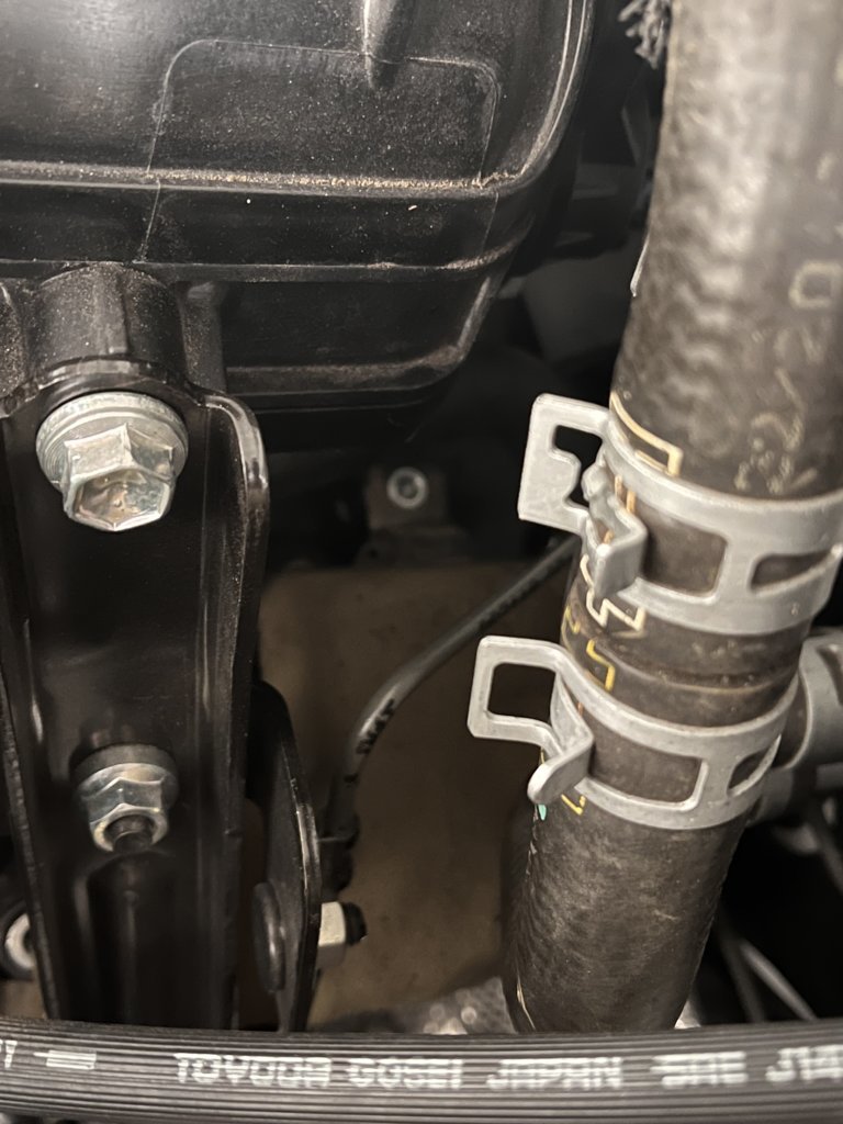

    IMG_1324.jpg Was doing the spark plugs . The one on the driver side closer to the cab has a foam padding that has a bolt went to put it in and the bolt snapped … tried to extract it no luck . Is it ok if the pad is not secured with a bolt . Don’t see this thing moving . I feel like it’s just an extra security bolt to hold it in place .

    Really no one ?

    Nice picture, but it might help to circle in red what you are talking about!

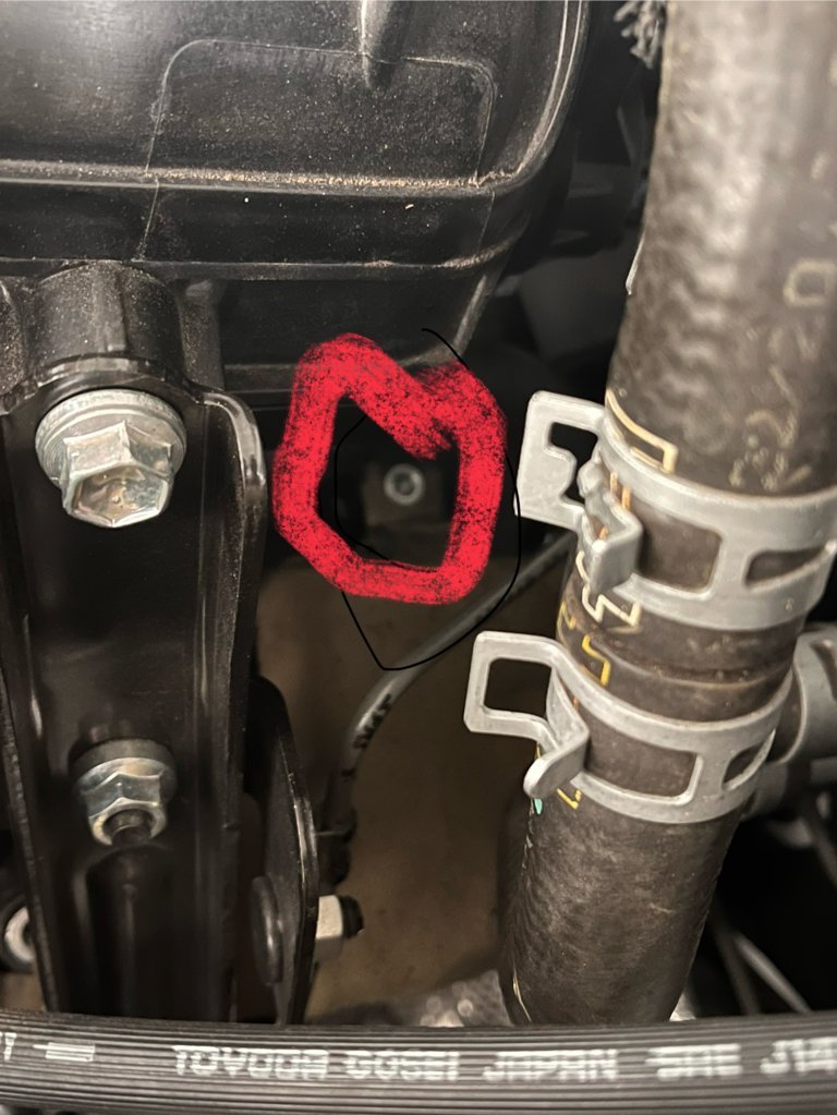

    There is a bolt that hold the foam padding.

    I have poor old vision but that's a really bad pic. Try to get a larger more clear one and also one of a proper "bolt" and pad in place. Might not be getting much help cause we can't see or understand.

    Was putting the bolt back in and when I went to tighten it it snapped .. didn’t feel like i over tightened it . When I took it off it was on pretty tight .

    what have you tried so far? I can't imagine the remaining piece is in there that tight, given it was overtightened and not rusted in place, maybe superglue a fresh m6 bolt or something on there, let it cure, then try spinning it out. Or center punch (a nice sharp auto punch) and a small left hand drill bit?

    Remove the foam padding and try to get a small pair of vice grips on it and turn it out providing the bolt is sticking out far enough.

    from the crappy pic, That looks like an amazing start to a good starter hole.....
    1/8" good quality drill bit, just fast enough to pull metal chips & good straight stable pressure....
    Best style extractor is a straight flute, at work we all use rigid 1/8" for exhaust work & smaller stuff...
    Ive extracted literally 1000's of broken bolts, didnt matter who broke them, they all came to me....
    I included a link to the style extractor im referring to but can see to source an 1/8" off eBay, maybe theres a # for it, you use an 1/8" drill bit...
    Ridgid makes them, you can get individuals & dont need to buy a set...
    Your hole isn't deep enough for an extractor to do anything at this point.
    If you have a crappy bit & drilling to fast, wasting your time.
    A good drill cobalt bit or similar, cuts like butter...

    Well figured out all this piece is a sound deadening foam . Has no real purpose . Not worth my time to get the bolt out if it stays cool if not I’m not worried about it . Thanks all for the advice .

    I would leave it as is. Or if you want, glue it down with something suitable. It's in a really tight spot to try and extract it.

    You can remove the foam piece proactively, to avoid any chance of it dislodging and say, falling on the exhaust.
