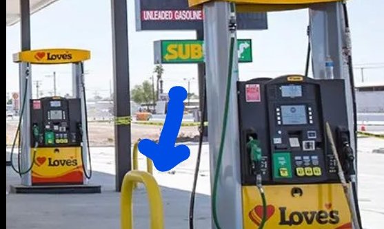

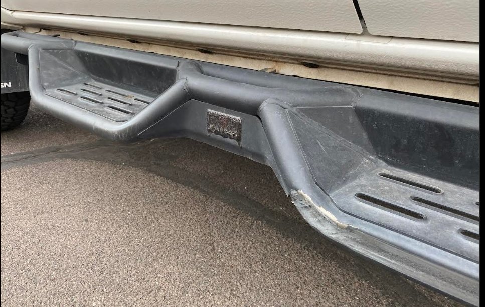

    Making a hard turn into a gas lane I hit one of those gas-pump-protector things,
    my 'steps' took the brunt and saved the body from any damage - thankfully.
    The step is bruised but not too bad however it's now slightly off angle - you can see
    the second step is at a downward angle a bit. The first one is too but not as bad. Was
    nearby my go-to-shop so I swung in there and asked if there was any secondary damage
    I should be worried about - the guy said nah those things acted like rock-sliders and
    saved your body from some potential damage....
    Then he suggested I get an old-school car-jack and jack-it-up and it might just angle it
    back up into place - this kinda makes sense to me - any thoughts out there about doing
    that or should I just live with it and worst-case replace that side?

    Before you go jacking it up, get underneath and visually inspect how much adjustment is needed and where.
    if it were me, I would fix or replace, but if I notice something that is off by a half degree from 50 ft on anything, so I couldn’t live with for very long.

    Loosen it and make sure you can adjust it to your satisfaction. (I think you can)
    Then remove it, clean and paint with a spray bedliner product, and 99.73% of the population will never notice the deformity.
    Then remove the other side and paint to match.
    Before reinstalling either, clean, prep and paint that pinch weld below the doors in the same black. It will make the truck appear 'taller' and the faux sliders 'beefier'.

    I wouldn’t try straightening it on the vehicle… just run the risk of bending something else.
    Take ‘em both off, beat on the bent one ‘’til it’s straight, sand, prime, paint.

    It's just a battlescar. Take a look underneath, bend it back in place and move on...

    Those things are attached (bolted) to the bottom (sill) of your taco's cab. I would not go pushing on these. - It is not a hard mounting point.
    - I suspect there was some flexing happening on the initial impact.
    I'd check the attachment points and surrounding areas for damage, then take those things off to work on them.
