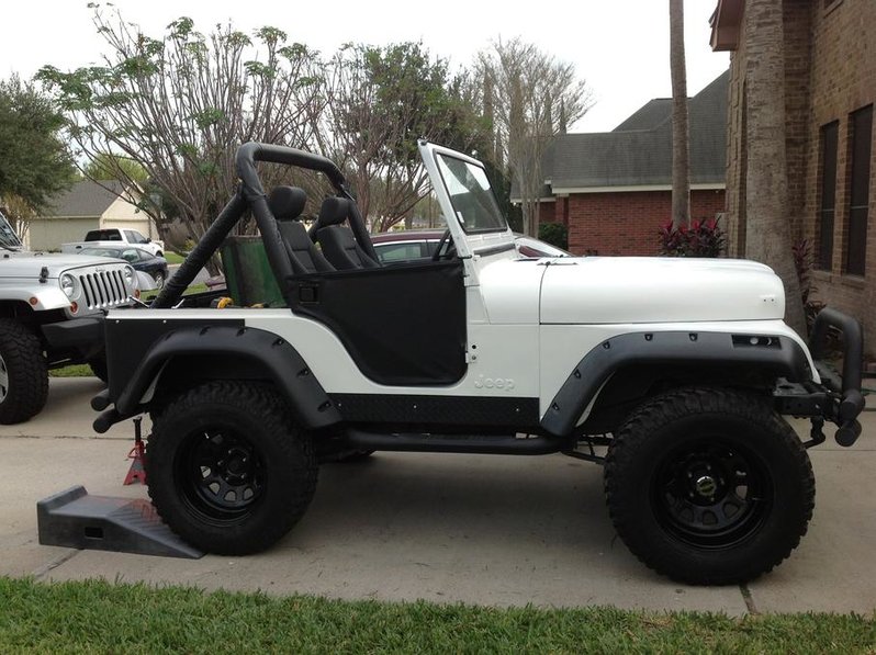

    Body lifts are ok if they are kept around an inch, I have one on my CJ5 that I am resto-modding along with a 3 inch suspension lift, works great. Plus the added bonus is getting better bushings than factory.
    As long as the bolts are stronger, bushings are better and spacers are top notch then go for it.

  15. Jun 22, 2013 at 4:23 PM
