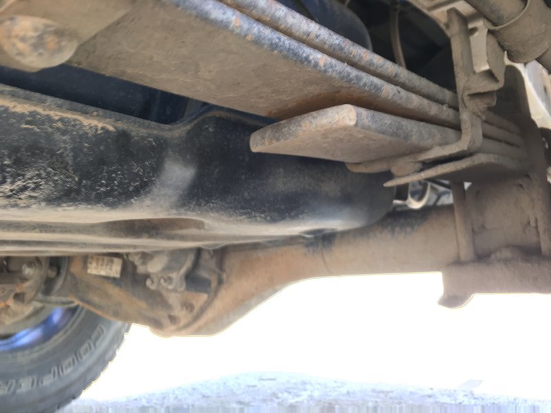

    image.jpg Bought this truck and cannot tell if I have an add a leaf. How many leafs should I have?

    You should have 3 leaf springs and a overload spring from factory.

    Not enough...
    But that looks too thin for an overload spring....

    It does look a little thin to me as well but it has no arch. Which means it would give you about a cm lift. So I don't think that is your add a leaf.

    + an add a leaf goes into the leaf pack not underneath

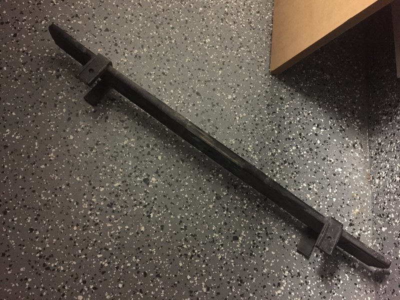

    This is what my overload looks like. Pulled it out 2 weeks ago when installing AAL 3-pack

    It looks like someone took the doing pack apart and put it back together wrong.

    Yeah, I was wondering if it should be in differently. So not add a leaf. Thanks

    Now looking at that, it looks like the overload and the bottom leaf are swapped and then the bottom leaf is upside down. wat.
    Does the other side look the same?

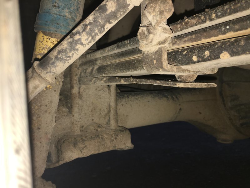

    Yes left side:image.jpg

    You can see where the bottom spring is hitting the rivet for the bracket. I bet that arrangement would soften the ride without lowering the height. These ride pretty soft now. Don't know why you would want a softer
