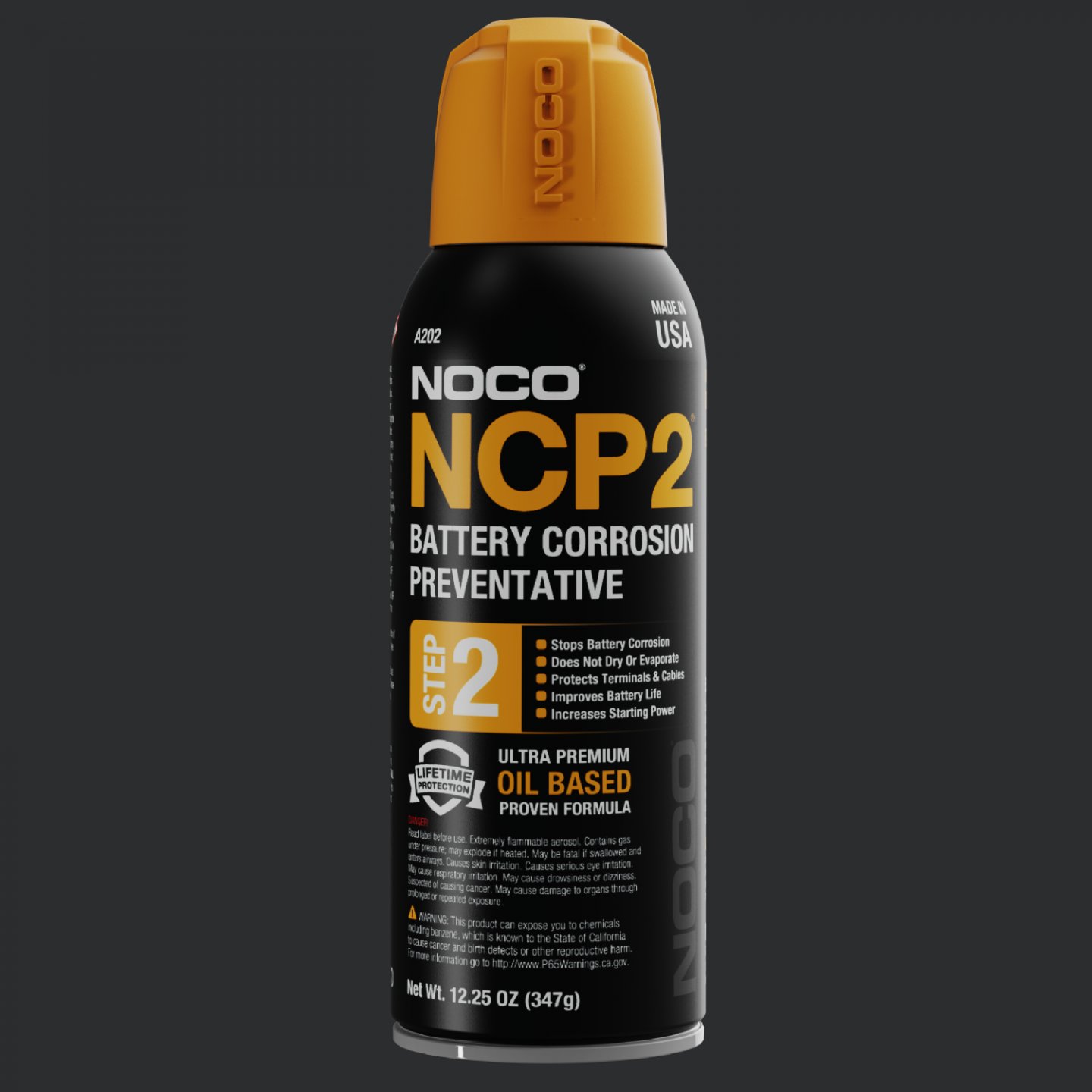

    If it’s a sealed battery and you’re getting corrosion it’s probably acid seeping up between the post and the battery case.
    Whatever you decide on to coat the terminals should be applied around the base of the terminal post where it meets the plastic case before the terminal goes on.
    I swear by this stuff…. your parts store sells it…..one can goes a long way.
