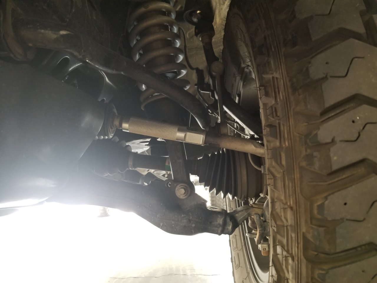

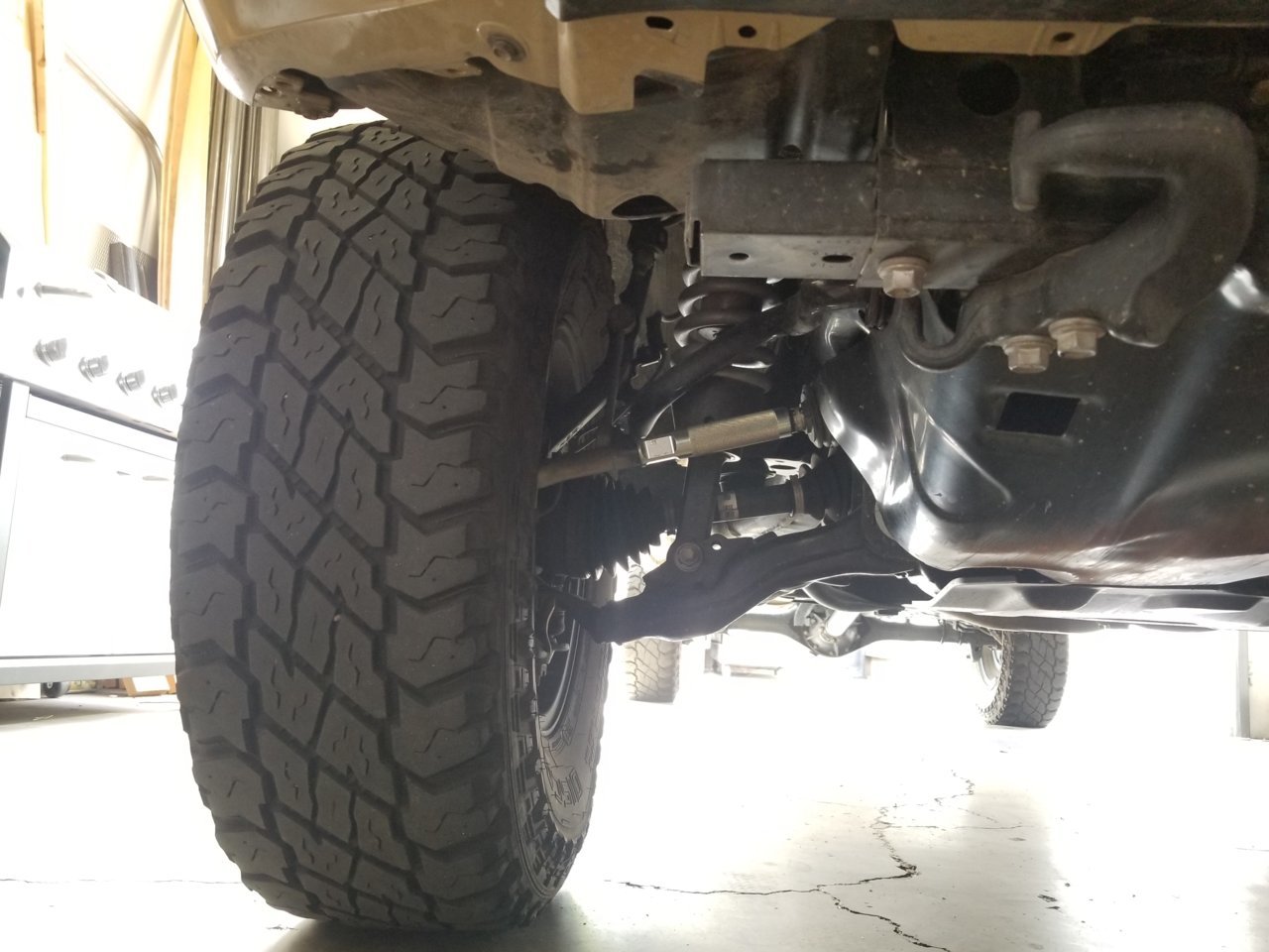

    And if anyone happens to be interested, here's what those came out like. 20181002_151923.jpg 20181002_151931.jpg
