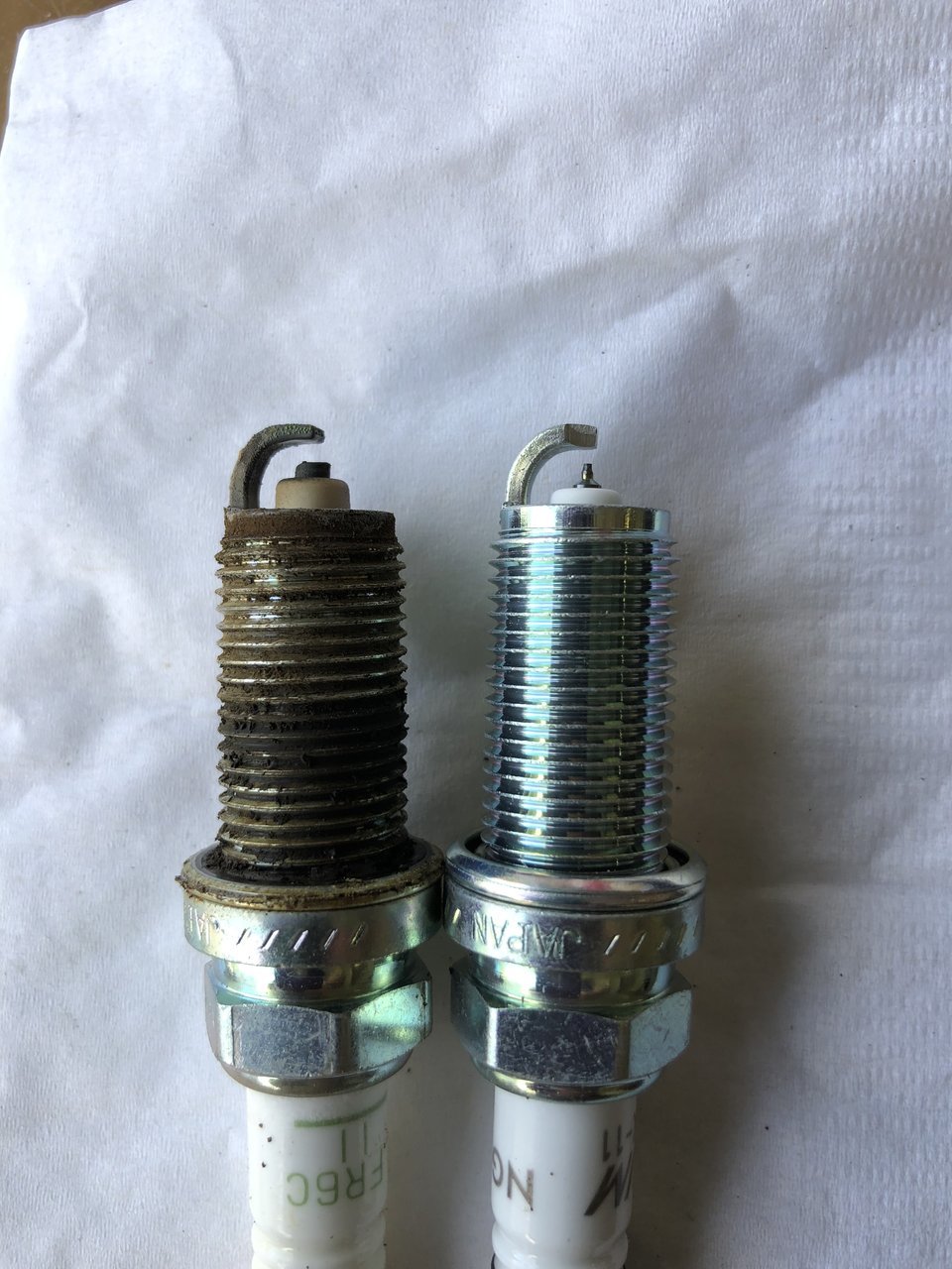

    This pic of most recent.

    I also see you went to an iridium plug? go back to coppers, they perform so much better in these engines.
