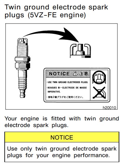

    Also, two other things: does the 5VZ-FE have dual-electrode or single-electrode plugs? I’ve ordered a set of 6 DENSO double platinum plugs (there weren’t any dual iridium ones) for my V6, AND if upgrading the plugs is a good idea in terms of longevity, reliability, cost and general quality. I saw a video from Scotty Kilmer saying he replaced the original copper plugs on his ‘94 Celica to iridium ones because of the plugs were under the intake manifold, implying they last longer.

    There should be a sticker on the timing belt cover that has the original plug specs. You can also download the owners manual for your truck here: https://www.toyota.com/owners/resources/warranty-owners-manuals
    They are twin ground electrode:
    Spark plugs in terms of "performance" is a bit of a :notsure:. Shy of installing a supercharger (and all that entails, spark plugs included), you're not going to notice a bit of difference between new OEM spec, platinum, iridium, etc.. As long as you replace them in normal intervals it's fine. You don't have to worry about removing the intake manifold to get to the spark plugs. Just the intake tube.

    Duly noted. Lastly, three other things:
    1) What is the factory plug gap spec and where do I find it?;

    1) Again, owners manual has you covered:
